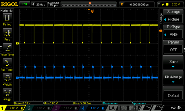

Greetings,
I am having an issue with my EPWM peripheral at high duty cycles (>0.92). The way I have the peripheral configured works well until I approach duty cycles > 0.92. At this point, occasionally a pulse that should be generated is missed. You can see this in the images below. Yellow is the PWM waveform and blue is a timing signal for the ISR, where the CMPA value is updated in the ISR. The blue waveform is set high at the start of the ISR (PWM counter = period, up down count mode), and is set low at the end of the ISR (The ISR takes just under 3 us).
1. Any ideas as to why there are occasional misses?
Here is how I have my peripheral configured: 60 kHz switching frequency, shadow load mode, up down count mode, shadow to active load on counter zero, action qualifier sets pin low during compare match during up count, action qualifier sets pin high during compare match during down count, 200 ns deadband. The ISR occurs at period match.
Here is the configuration code:
EPWM_setPeriodLoadMode(pwmHandle[base], EPWM_PERIOD_SHADOW_LOAD);
        EPWM_setTimeBasePeriod(pwmHandle[base], INV_PWM_TICKS / 2);
        EPWM_setPhaseShift(pwmHandle[base], 0);
        EPWM_setTimeBaseCounter(pwmHandle[base], 0);
        EPWM_setTimeBaseCounterMode(pwmHandle[base], EPWM_COUNTER_MODE_UP_DOWN);
        EPWM_setClockPrescaler(pwmHandle[base], EPWM_CLOCK_DIVIDER_1,
                               EPWM_HSCLOCK_DIVIDER_1);
        EPWM_disablePhaseShiftLoad(pwmHandle[base]);
        // sync "down-stream"
        EPWM_setSyncOutPulseMode(pwmHandle[base],
                                      EPWM_SYNC_OUT_PULSE_ON_COUNTER_ZERO);
        // Counter Compare Submodule Registers
        // set duty 0% initially
        EPWM_setCounterCompareValue(pwmHandle[base], EPWM_COUNTER_COMPARE_A, 0);
        EPWM_setCounterCompareShadowLoadMode(pwmHandle[base],
                                             EPWM_COMP_LOAD_ON_CNTR_ZERO);
        // Action Qualifier SubModule Registers
        // Time base counter up equals COMPA and set output pins to low
        // Time base counter down equals COMPA and set output pins to high
        EPWM_setActionQualifierActionComplete(pwmHandle[base], EPWM_AQ_OUTPUT_A,
                (EPWM_ActionQualifierEventAction)(EPWM_AQ_OUTPUT_LOW_UP_CMPA |
                                               EPWM_AQ_OUTPUT_HIGH_DOWN_CMPA));
        // Active high complementary PWMs - Set up the deadband
        EPWM_setRisingEdgeDeadBandDelayInput(pwmHandle[base],
                                             EPWM_DB_INPUT_EPWMA);
        EPWM_setFallingEdgeDeadBandDelayInput(pwmHandle[base],
        EPWM_setDeadBandDelayMode(pwmHandle[base], EPWM_DB_RED, true);
        EPWM_setDeadBandDelayMode(pwmHandle[base], EPWM_DB_FED, true);
        EPWM_setDeadBandDelayPolarity(pwmHandle[base], EPWM_DB_RED,
                                      EPWM_DB_POLARITY_ACTIVE_HIGH);
                                      EPWM_DB_FED, EPWM_DB_POLARITY_ACTIVE_LOW);
        // for redcount, fedcount = 200, dead time = 2us -> 10 ns/count
        EPWM_setRisingEdgeDelayCount(pwmHandle[base], DT_DELAY_COUNT);
        EPWM_setFallingEdgeDelayCount(pwmHandle[base], DT_DELAY_COUNT);
EPWM_setInterruptSource(EPWM1_BASE, EPWM_INT_TBCTR_PERIOD);
This is for a three phase motor control application. So the ISR performs the field oriented control calculations, and then updates the shadow register with the next duty cycle value.
2. Shouldn't the shadow register retain it's value and load to the active register each time the PWM counter hits zero? If I perform my ISR at period count, for a 60 kHz PWM (16.67 us period) that means I have 8 us to perform the calcuations and update the shadow register before the counter reaches the zero count, at which point the shadow register value is loaded to the active register.
The result is a large amount of current distortion at high duty cycles when operating the motor. I'm trying to get the motor to operate in overmodulation, but with this bug there is to much current distortion which leads to instability and a loss of control.
Thanks.

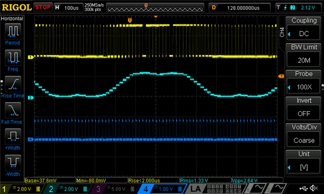

    Thanks for the response. Yes, I am updating the CMPA register in a similar manner as the example you pointed to. First the ISR interrupt occurs when the PWM time base counter is equal to period. For 60 kHz, and an EPWM clock divider of 1 in up down count mode, this gives a count of 833. The first thing I do when I jump into the ISR is update the CMPA registers from the previous interrupt's calculations, using the following section of code:
    //  Computed Duty and Write to CMPA register
    //  Update Duty Cycle from previous interrupt
        EPWM_setCounterCompareValue(EPWM1_BASE, EPWM_COUNTER_COMPARE_A,
                            (uint16_t)((INV_PWM_HALF_TBPRD * svgen.Tc) + INV_PWM_HALF_TBPRD));
        EPWM_setCounterCompareValue(EPWM2_BASE, EPWM_COUNTER_COMPARE_A,
                            (uint16_t)((INV_PWM_HALF_TBPRD * svgen.Ta) + INV_PWM_HALF_TBPRD));
        EPWM_setCounterCompareValue(EPWM3_BASE, EPWM_COUNTER_COMPARE_A,
                            (uint16_t)((INV_PWM_HALF_TBPRD * svgen.Tb) + INV_PWM_HALF_TBPRD));
    Here, INV_PWM_HALF_TBPRD = 416. The svgen.Tx (which is the light blue space vector waveform in the above scope capture) variable varies from -1 to 1, which makes the value being sent into the function vary from 0-832. I spend the rest of the ISR calculating the svgen.Tx duty cycles for the next interrupt. The value doesn't update from the shadow into the active register until the PWM time base counter equals zero.

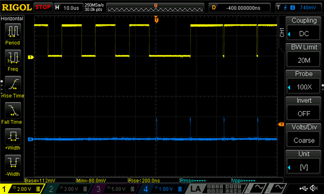

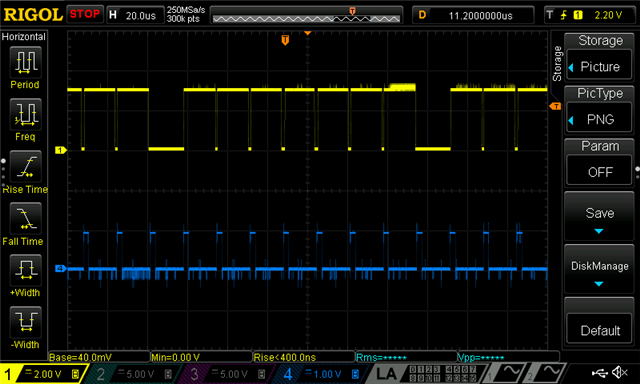

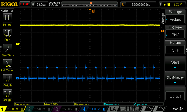

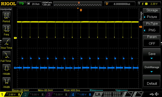

  • Hi Ryan, I attempted to software force the synch as you suggested, but this did not resolve the issue. I called the EPWM_forceSynchPulse(EPWM1_BASE) function at the start of the ISR (i.e., this is where the time base counter = period). Do you have any other ideas?
    It is odd that it misses above a particular duty cycle. If I write a constant value to the CMPA register, there is no issue with the PWM missing, as you can see in the plots below:
    Duty Cycle = 90%
    Duty Cycle = 95%
    Duty Cycle = 100%
    This leads me to believe that it only misses the first pulse of the new duty cycle. I will perform some tests to see if I can verify this. I also found this thread, which may be related:
    https://e2e.ti.com/support/microcontrollers/c2000-microcontrollers-group/c2000/f/c2000-microcontrollers-forum/646249/tms320f28075-type-4-epwm-to-generate-full-range-0-100-duty-cycle-waveform-w-o-isr-intervention
    However, this is for overmodulation. I haven't reached overmodulation yet when I experience the issue.
  • Yes it seems like it's missing the first action qualifier event when the CTR is going  in the down direction for some reason and only happening for some events as your waveforms are showing.

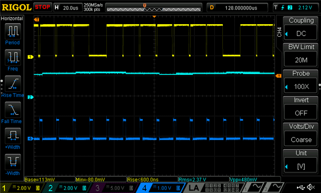

  • Hi Ryan, I have verified that only a single pulse is missed. In the first scope capture, the duty cycle changes from 0.2 to 0.95. As you can see, the first pulse is missed by the EPWM peripheral at this transition:
    If I change the duty cycle from 0.2 to 0.9, the pulse does not miss, and the EPWM peripheral performs properly:

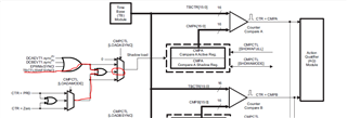

    Thanks again for your support. I found the bug that is causing my issue. The compare value was not being loaded to the shadow register, it was being loaded to the active register. At the high duty cycle, the comparison needs to be made very fast after the period interrupt. I think that the load to the active register was happening after the comparison, therefore it misses the updated duty cycle. I checked the CMPCTL[SHDWAMODE] bit, and it was indeed set to 1, which is immediate load mode. Manually changing the bit to 0 resolved the problem. Now the shadow loads to the active at TBCTR == 0 and the pulse does not miss.
    However, this is odd since I was using the following function:
    I believe this is the function that is supposed to control that bit. There may be a big in the function. Thanks again for your assistance, it is greatly appreciated.

    The function that controls the shadow A mode would be the one you described. However on reset the default value should have been 0. I am unsure on how that bit was changed to 1 during your run time/debugging.
    I also stepped through an example project and viewed the registers within CCS, the SHDWAMODE bit was set to 0.
    Ryan Ma
  • Thanks for checking Ryan. Indeed, you are correct. I just found the cause of the bit getting set to 1. I used the fast current loop example code to start this project, and in the function FLC_initPWM() the shadow load mode is disabled. This was the cause of the bit being set to 1.
