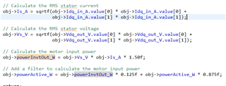

Only the output power calculation is in Universal lab. The input power can't be calculated directly, you have to add the current sensing circuit accordingly. And the calculation power is not related to the motor control algorithm, that could be used for InstaSPIN as well.
In the motor_common.c source file in line 757 there is power calculation, and comment suggest it is reagrding input power.
Yes, it's the input power of the motor that's equal to the output power of the inverter, not the input power of the inverter.
