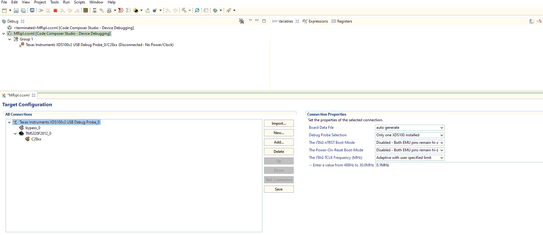

Hi Yehoram,
Could you send me a screenshot of you target configuration in the Advanced tab? Reading your older posts, I am still somewhat confused by what you are trying to do. Are you just trying to program the FPGA while the TMS320F2812 is bypassed, or do you want to do something else with the TMS320F2812? Could you also send a screenshot of where you inputted the BYPASS BIT value?
Ben Collier
i am trying to config the TMS320F2812.
FPGA can be config thru QUARTUS (FPGA software), FPGA configuration work.
TMS320 doesn't work.
attach picture
Hi Yehoram,
Oh ok, I think that I initially misunderstood your goal. You are trying to bypass the FPGA so that you can program the TMS320F2812? So in this case, you need to find the number of bypass bits for the FPGA.
Your target configuration looks correct, you will just need to find the correct number of Bypass Bits for the FPGA. I am not sure where to find that information, maybe there is some way to find out with QUARTUS or there is some support you can seek for the 10M08SAU169C8G ?
