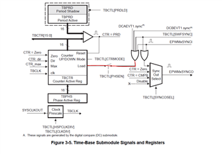

  • Hi Puneeth,
    Yes there is a way to enable phase shift between two EPWM modules.
    I can provide a list of educational material that could help demonstrate Phase shift. Basically what you are going to need to do is enable phase shift load
    EPwm2Regs.TBCTL.bit.PHSEN = TB_ENABLE;
    Then depending on when which SYNCOUT event you want to do a phase shift load you can select it with the TBCTL[SYNCOSEL] = 00. Usually it's typical to have EPWM1 to be master.

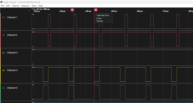

  • Thanks Ryan,
    I've tried everything, still no phase shift but I can see the PWMs perfectly without phase shift even I read the documents that were shared.
    this is the last part left in the whole programming part.

  • Hi Puneeth,
    EPwm1Regs.TBCTL.bit.PHSEN = TB_ENABLE; // EPwm1 is the Master
    EPwm1Regs.TBCTL.bit.SYNCOSEL = TB_SYNC_IN;;
    Is your epwm1 being synced with an external gpio pin? If so you can validate this on oscilloscope by bringing this to a gpio pin as an output.
    If you're not planning to use a gpio pin in your synchronization, your epwm1 should select a syncout event (TBCTL[SYNCOSEL]).
    If you're planning to use epwm1 as the master and do not have a gpio sending out a syncout, you'll need to disable the PHSEN for epwm1.

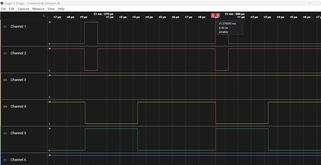

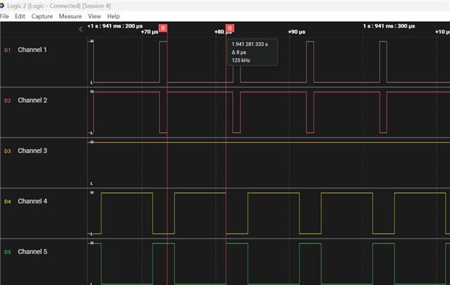

  • Hi Ryan,
    This helped to certain extent, but there was something that was not expected
    i. I was expecting phase shift in EPWM2 and EPWM3 but it was observed only in EPWM3.
    ii. Always a fixed 180 degree phase shift was not observed, to obtain which I had modify TBPHS whenever duty cycle varied.
         For ex: if duty cycle was 20% I had to maintain TBPHS as 420,
                        duty cycle as 50% TBPHS would be 600
                        70% duty cycle TBPHS would be 120
                        at 90% duty TBPHS would be 240
    How to avoid this

  • Could you show me the waveforms of your duty cycle and what your phase shift values are on an oscilloscope?
    Ryan Ma
  • Hi ryan,
    Please find the screenshot obtained from logic analyser
    In this channel 1 is PWM1A, channel 2 is PWM1B
    Channel 4 PWM3B and Channel 5 is PWM3A
    Frequency of both PWM1 and PWM2 is 100Khz, hence 10 us is the period.
    The phase shift is mentioned in terms of us (microseconds). TBPHS was maintained 300 constant through out, it can be seen that phase shift is not constant.
    Fig1, PWM1 duty cycle was 10%, PWM3 was 20%
    Fig 2, PWM1 duty cycle was 10%, PWM3 was 30%
    Fig 3, PWM1 duty cycle was 10%, PWM3 was 40%
    Fig 4, PWm1 duty cycle was 10%, PWM3 was 60%
    Also phase shift can be seen in the images.
    --thanks
    Puneeth
