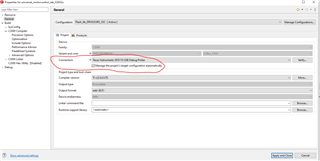

CCS is showing programming error from yesterday. It was working for a week before that.
Error is
I used command based debug tools of xds110.. Updated boot loader and firmware. I get below details with xdsdfu - e
Device manager in my PC shows ...
CCS Debug configuration shows...XDS100
I tested same LAUNCHXL-F280025C on another 2 computers with CCS and same Universal Motor control project. Getting same error in other systems too.
Please note that CCS shows it as XDS100 where as everywhere else it XDS110.
Please help to sort out this issue so that I can continue my Universal Motor Control Lab project..
