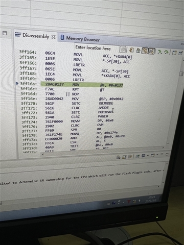

Using the xds560V2 emulator to debug 28377d programs, when calling FlashAPI to erase the N sector, the program cannot work properly (An irregular write, while previous flash writes can be successful).
The xds100v3 emulator is used but does not have this issue. It is also good to operate the flash when the program downloaded with these two emulators is running offline.
The Flash write command is transmitted to DSP via the serial interface. Functions that mask flash writes do not exhibit the above issues.  CCS sometimes displays out at address 0x0 or 0x3ff16a when a problem occurs. Sometimes it also suddenly stops at _Fapi_issueFsmCommand. The program can only be downloaded again after flying and cannot be restarted.

    Using the xds560 erase is a program that calls flashapi to read and write internal flash, but the emulator used by debug is xds560. When an SCI command is issued externally, there is a high chance that an error will be reported on a particular call during the lower computer program call flashapi to read and write.
    However, when doing the same with xds100v3, no error is reported. The lower computer program is running in BCDEF, not in N sector.
    Debug via the xds560, send commands to DSP over the serial interface and DSP calls flashapi for data erase and write. The purpose of connecting the emulator is to see if the data was written correctly, but during this process, However, in this process, CCS errors and direct reset of DSP will occur randomly and occasionally.  But before that, the data can be written correctly.
