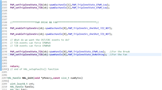

  • I want to change during run time, it's like one is for break and another one is for control single switch Buck converter (which is power supply source for some of the on board components).

  • Yes, I am trying that only before this but I don't know why it is not working and don't go with the name PWMDAC It's a just define like that it's working like pwm only
    and with this operation whenever I forcefully set OST it's triggered both the Output.
    I am using instaspin library.

  • Yes, I already check that angle too.
  • Hi Divyesh,
    Could you send me a screenshot of your register view when debugging (with the epwm regs you're expecting to have a different trip output) when it  steps through lines 2182/2183 and 2198/2199?
    You should be able to see TZA / TZB change their values.
    Ryan Ma
