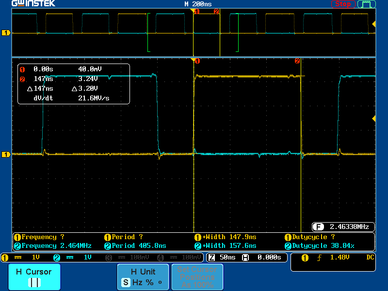

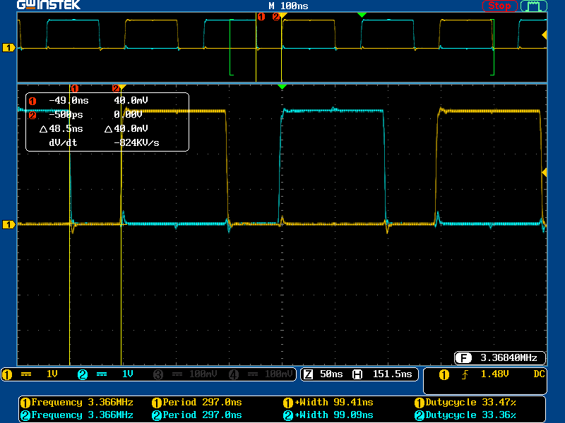

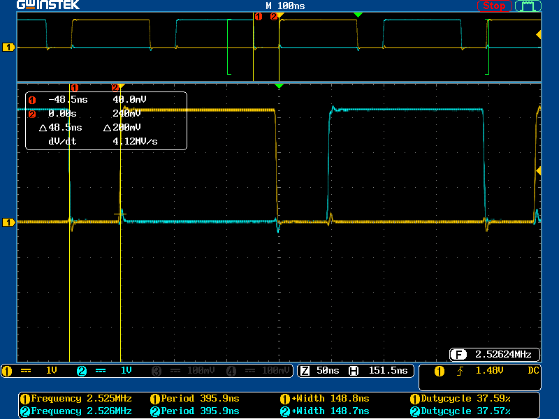

Here is my waveform when using only ePWM:
When TBPRD is fixed, ePWM is stable.
The ePWM is also stable when I change TBPRD.
When my TBPRD is changing, its DEAD TIME is fixed, and the subsequent ePWM is also stable.

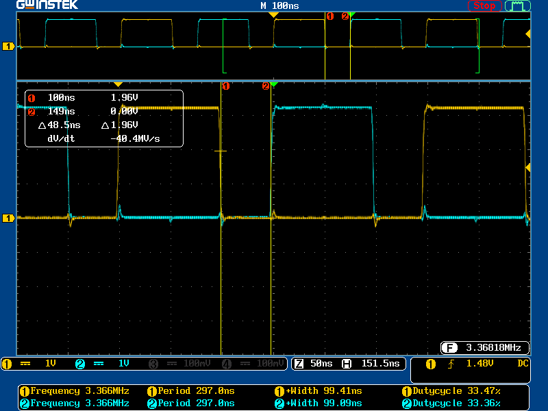

If the above two TBPRD values change continuously, the following situation can be seen from the oscilloscope.
The above actions are also what I hope hrpwm can do.

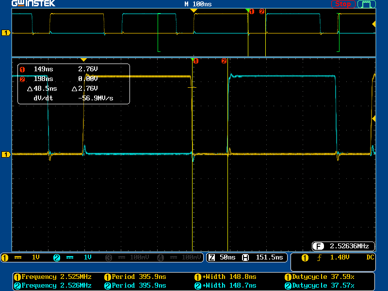

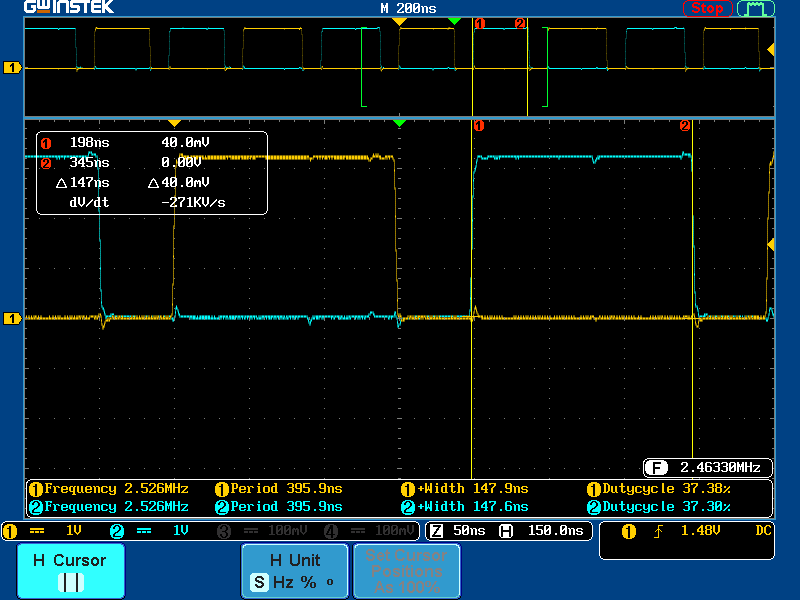

Here is the waveform when using HRPWM:
TBPRD is fixed, give TBPRDHR a fixed value of 0x8000 (128U).
At this time, I hope that the HRPWM output is accurate and stable, but there is a problem of cycle jitter.

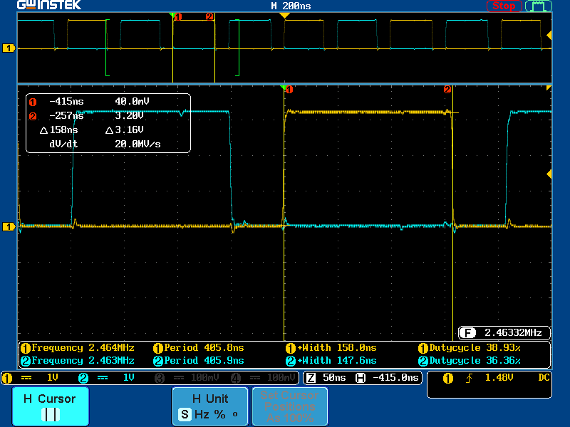

Observing the continuous action with an oscilloscope, I found that the period is changing, but I clearly gave a fixed value.
The above is all my experiments, I hope it will give you a better understanding of my problem.

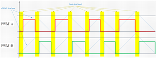

The following briefly introduces the behavior mode of epwm, and attaches my project file.
I use up and down counting mode for ePWM and set ActionQualifier of ePWM1A to TBPRD = ZRO is high, TBPRD = PERIOD is low, ePWM1B is AHC mode.
as follows:
When I change the value of TBPRD, what I want is that the dead time is fixed, output A and output B have the same high time/low time and duty cycle.
This can be achieved in ePWM mode as shown in the scope waveform in the reply above.
But when I enable HRPWM mode, it produces cycle jitter when TBPRD and TBPRDHR are fixed. Refer to the oscilloscope waveform in the reply above.

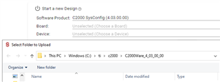

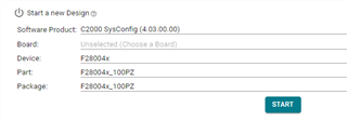

Would it be possible for you to run an hrpwm example from C2000Ware and see if you observe any jitter on your end? If you don't, then I would start by comparing the setting within the example and your project.
Also, you could use SysConfig to setup your epwm module (with the hrpwm capability) to see if there are any issues/warnings with your configuration.
1) Download SysConfig: https://www.ti.com/tool/SYSCONFIG
2) After the download, launch SysConfig and under 'Software Product' select your C2000Ware install.
For 'Device' select F28004x and then the pin package you have:
3) Click 'Start'
4) Go to the 'EPWM' module on the left hand side and click the (+) sign

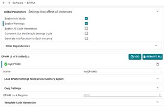

5) Under the 'Global Parameters' at the top of the EPWM module, make sure to select 'Enable Info Mode' and 'Enable Warnings'
5) You can then start configuring the 'hrpwm' module with the settings in your program and address any warnings or info there might be within your own program.
We've captured all TRM notes regarding incorrect setup in this tool.

Although we use the upper and lower counting mode, our duty of period is not a symmetrical comparison in the middle, but the upper counting part controls the duty of the upper leg, and the lower counting part controls the duty of the lower leg. In this case, we turn on HRPWM to control the decimal part of the cycle, which will cause it, the cycle is unstable.
Can you help us to confirm that hrpwm can be used in such mode?

Jiang,
Were you able to test out SysConfig?

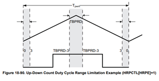

In general, yes, HRPWM can be used. There are some limitations when using HRPWM which are incorporated into our SysConfig tool and the TRM.
For example, if you are using HRPWM in UPDOWN count mode then you have to use ACTIONS at CMPxU and CMPxD to get the HR EDGES. You also have to stay out of the UNSUPPORTED 3 cycle ranges.
