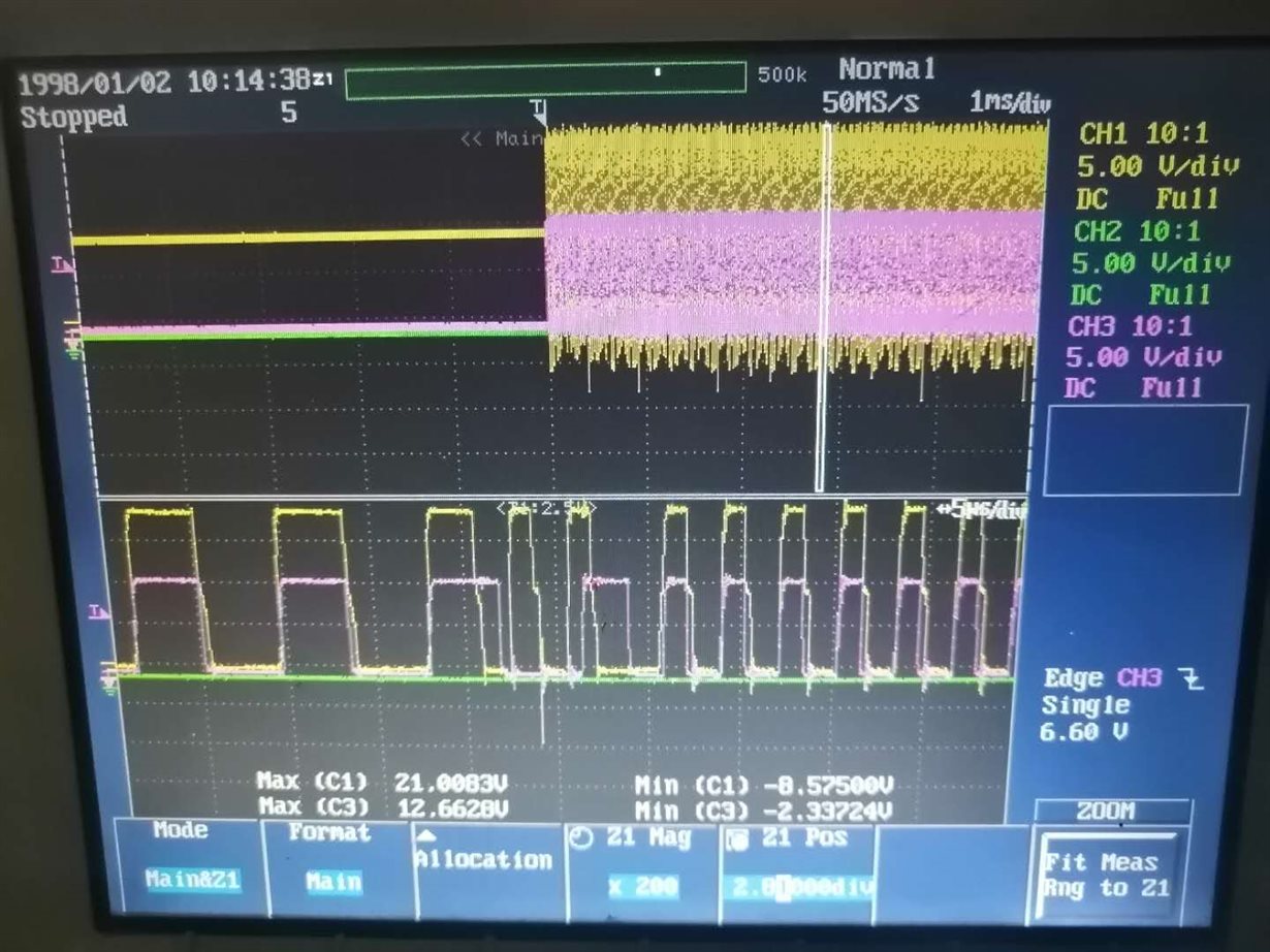

Dear team:
I used HRPWM1and HRPWM2to do synchronous frequency conversion experiments, The cycle, CMPA and CMPB of HRPWM2 follow HRPWM1.
1, When EPwm1Regs.CMPA.bit.CMPAHR is a fixed value, the frequency conversion is normal.
When EPwm1Regs.CMPA.bit.CMPAHR changes with frequency, the first cycle of frequency conversion will be abnormal, and the second cycle will be normal.
Configuration is below:

  • What are the signals in the image?
  • yellow:HRPWM1
    pink:HRPWM2
    I am sorry,The above description is not correct。 EPwm1Regs.CMPA.bit.CMPAHR is always a fixed value.
    1、 When EPwm1Regs.TBPRDHR is a fixed value, the frequency conversion is normal.
    2、When EPwm1Regs.TBPRDHR changes with frequency( from 120k to 310k  or from 310k to 120k), the first cycle of frequency conversion will be abnormal, and the second cycle will be normal.
    a、The cycle, CMPA and CMPB of HRPWM2 follow HRPWM1 as follow

  • Does disabling the synchronization eliminate the wrong first cycle output?
    Nima
  • EPwm1Regs.TBCTL.bit.SYNCOSEL   =TB_SYNC_DISABLE can eliminate the wrong first cycle output.
    but out of synchronization with phase difference:
    And waveform is the same when
    EPwm2Regs.TBCTL.bit.SYNCOSEL   = TB_SYNC_IN or  EPwm2Regs.TBCTL.bit.SYNCOSEL   = 3TB_SYNC_DISABLE
  • How to disable the synchronization

  • dear  Nima
    Deleting the following two lines of code can eliminate the wrong first cycle output.
    EPwm1Regs.HRPCTL.bit.TBPHSHRLOADE = 1; //delete
    EPwm2Regs.HRPCTL.bit.TBPHSHRLOADE = 1;//delete
    But high resolution duty control can not work When EPwm1Regs.TBPRDHR  and EPwm1Regs.TBPRD are a fixed value.
    EPwm1Regs.CMPA.bit.CMPAHR = 0,the duty of PWM1 is equal to 48.2%
    And  EPwm1Regs.CMPA.bit.CMPAHR = 0xff00,the duty of PWM1 is still equal to 48.2%
    EPwm1Regs.CMPA.bit.CMPA =208;
    EPwm1Regs.CMPA.bit.CMPAHR = 0xff00;
    EPwm1Regs.CMPB.bit.CMPB = 208;
    EPwm1Regs.CMPB.bit.CMPBHR = 0;
    it is not possible to use both edges controlled by CMPA and CMPB events?
  • What you can do is in HR mode use CHANNEL A, with CMPA events (CMPAU CMPAD)
    Use Channel B with CMPB events (CMPBU CMPBD)
    You dont want to use CMPA and CMPB on the same channel.
  • Did this solve your issue?
    Nima
  • I am going to close this for now. If you have a question that I failed to answer please reply with that specifically below.
  • Can you provide an update for this?
  • Going over your thread again, I didnt think this was a global load issue.
    EPwm2Regs.EPWMXLINK.bit.GLDCTL2LINK = 0  or   EPwm2Regs.EPWMXLINK.bit.GLDCTL2LINK =1 should not affect the output.
    You mentioned:
    "Deleting the following two lines of code can eliminate the wrong first cycle output.
    EPwm2Regs.HRPCTL.bit.TBPHSHRLOADE = 1;//delete"
    That would possibly be the issue as you are not using HR phase shift, since you are already using HR period and HR duty.
    Finally,
    "EPwm1Regs.CMPA.bit.CMPAHR = 0,the duty of PWM1 is equal to 48.2%
    EPwm1Regs.CMPB.bit.CMPBHR = 0;"
