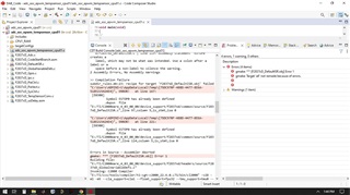

In the console window, could you go to the top where it will mention the error and share a screenshot? The error message will be illuminated in red.
Thanks.
Directly Running the example file from E:\TI\C2000Ware_4_03_00_00\device_support\f2837xd\examples\cpu1 folder.
I have shared the screenshot for your reference.
gmake: *** [F2837xD_DefaultISR.obj] Error 1 adc_soc_epwm_cpu01 C/C++ Problem
gmake: Target 'all' not remade because of errors. adc_soc_epwm_cpu01 C/C++ Problem
The above error i am getting while compiling the example code.

The error you are seeing is because "ESTOP0" is being defined in multiple places.
It is possible (albeit unlikely) that some of the files might have gotten corrupted.
Could you share the F2837xD_device.h and F2837xD_DefaultISR.c files, that you are currently working with?

All "asm" instructions need to be preceded with a space, otherwise it is read as a function.
This means that the "F2837xD_DefaultISR.c" will need to be updated wherever there are no spaces.
For eg.
asm ("ESTOP0"); -> Needs to be replaced with -> asm (" ESTOP0");
