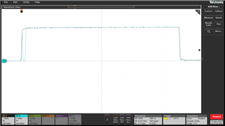

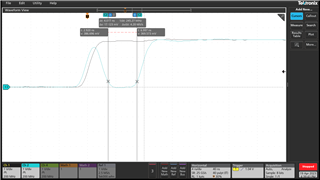

I am facing some problems in implementing active-high complementary PWM with dead-band and high resolution mode on TMS320F280039C. I want to use it to control a three-phase six-switch inverter with symmetrical PWM pattern or space vector modulation.
At first, everthying looks good. But by varying the duty cycle across the full range, I've detected glitches on the rising edges, as you can see on my following measurements:
CH1 (black): PWM2A output, J4 pin 38
CH2 (blue): PWM1A output, J4 pin 40
I have written small test code for use on the LAUNCHXL-F280039C with fixed duty cylces which shows the glitches from my measurements:

With a different value of RED_FED, the duty cycle at which the glitches occurs is different. So it seems that there is a correlation between them. The problem also occurs when I use a reduced clock frequency for the ePWM modules. So maybe there is an issue in the initialization of the eWPM modules?

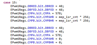

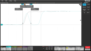

  • Hi Luke,
    I have found a few combinations where the glitch occurs. The glitch only occurs if the HR components (CMPAHR, CMPBHR) are not equal to zero.
    I quickly expanded the code to show multiple cases. In the "epwm_isr_0" ISR, 16 cases are run sequentially and in each the MEP of EPwm1 is varied from 0 to MEP_ScaleFactor. EPwm2 gets the same set of CMPA and DBRED / DBFED values, but with zero CMPAHR and CMPBHR values.

            case 15:
                EPwm1Regs.DBRED.bit.DBRED = 48;
                EPwm1Regs.DBFED.bit.DBFED = 48;
                EPwm1Regs.CMPA.bit.CMPA = 578;
                EPwm1Regs.CMPA.bit.CMPAHR = mep_isr_cnt * 256;
                EPwm1Regs.CMPB.bit.CMPBHR = mep_isr_cnt * 256;
                EPwm2Regs.DBRED.bit.DBRED = 48;
                EPwm2Regs.DBFED.bit.DBFED = 48;
                EPwm2Regs.CMPA.bit.CMPA = 578;
                EPwm2Regs.CMPA.bit.CMPAHR = 0;
                EPwm2Regs.CMPB.bit.CMPBHR = 0;

    This setup allows to easily detect the glitches with an oscilloscope by triggering on the rising redge of EPwm1's output.
    To test the symmetry, I also created case 16. In this case statement I can easily check the symmetry of the two channels, which looks god.

    I am able to recreate the issue on my side. This may be a common issue with HRPWM and deadband, I will consult with our other EPWM experts on what the cause of this may be and get back to you by tomorrow.
    Thank you,
    Luke

    Thank you for your suggestions. I have checked these. Disabling high-resolution period (HRPCTL.bit.HRPE = 0) prevents the glitch from occuring. But with this the symmetry is lost: If I configure two ePWM modules the same and set the same CMPx values on both, but set a non-zero CMPxHR value on only one module, the switching patterns are not centered on their midpoint.
    Disabling the MEP calibration logic (HRPWR.bit.CALPWRON = 0) does not influence the glitch.
    I got a Launchpad with a F280049C from my colleague. I will try the ePWM configuration on this board. If I get the same results and you can confirm that the ePWM configuration (AHC with Deadband, High-Resolution) is correct, I suspect that it must be a problem of the ePWM module.

    the glitch also occurs on the F280049C.
    Here is the code for LAUNCHXL-F280049C:

        init_pwm_gpio();
        init_pwm();
        EINT;           // Enable Global interrupt INTM

            case 15:
                EPwm6Regs.DBRED.bit.DBRED = 48;
                EPwm6Regs.DBFED.bit.DBFED = 48;
                EPwm6Regs.CMPA.bit.CMPA = 578;
                EPwm6Regs.CMPA.bit.CMPAHR = 0;
                EPwm6Regs.CMPB.bit.CMPBHR = 0;
                break;

  • Hi Stefan,
    I've noticed a pattern with each of the combinations of rising edge/falling edge delay and your CMPA value. If you take the point in time that the up-count CMPA event occurs and add the rising edge delay to it, the resulting event will fall near or past the time when the down-count CMPA event should occur. Since the input to the dead-band module is first passed through the rising edge delay module before being passed to the falling edge delay module, the output of the rising edge delay module will have a have a rising edge that occurs after it's falling edge. I'm not sure how the falling edge delay module would handle this input when HR is enabled. This may be a new edge case with behavior we have not documented to customers, however it could be related to our advisory to not have an CMPA value within 3 clock cycles of TBCTR =0 when HRPWM is enabled.
    The F28003x TRM contains the following note:
    "Phase shifting B-channel with respect to the A-channel: When PWMxB is derived from PWMxA using the DEDB_MODE bit and by delaying rising edge and falling edge by the phase shift amount. When the duty cycle value on PWMxA is less than this phase shift amount, PWMxA’s falling edge has precedence over the delayed rising edge for PWMxB. It is recommended to make sure the duty cycle value of the current waveform fed to the dead-band module is greater than the required phase shift amount."
    In the cases you have created, the duty is less than the "phase shift" that is created from the rising edge and falling edge delay values. This may violate the note above.
    Please note that Half Cycle Clocking Enable Bit of the Dead-Band Generator is enabled (DBCTL.bit.HALFCYCLE = 1) in order to use the high resolution mode.
    TRM, SPRUIW9A, Page 2191
    Due to the Half Cycle Clocking, in all my cases the on times or duties are longer than the delay introduced by the RED or FED.
    Even if the Dead-Band Generator does not operate in high-resolution mode by, the glitch occurs.
    Is the purpose of the following code (using the same value for rising edge and falling edge delay) just to create a phase shift?
    (note that the duty in this code example would be 44 clock cycles (2*(600-578)), while the phase would be 48. This could potentially violate the note above)
    If so, have you considered using the TBPHS register to achieve this use-case?
    As described above, this will not violate the requirements of the TRM. With the values we get:
    duty in cycles = 2 * (PRD - CMPA) =2 * (600 - 578) = 44
    RED in cycles = DBRED / 2 = 24
    This case is used to compare ePWM1 with ePWM6, both of which operate in high-resolution mode, but only ePWM1 is fed with fractional CMPA and CMPB values. I have tried many different settings to get the AHC mode to work in HR mode. This configuration I posted above seems to be the only one that works and produces balanced output pulses. Therefore, this case is for verification of the configuration.

  • Hi Luke,
    I have attached the project in a zip file to this post.
    The bandwith of my scope is 200 MHz. I used passive probes with 10:1 divider and a bandwidth of 250 MHz. This results in a bandwidth (3 dB) of approx. 143 MHz with an approximation as first order system. I also used a ground spring to minimize the ground inductance.
    The glitch occurs on cases 0 to 15 with an CMPAHR and CMPBHR value not equal to zero.
    I think you were correct in your assumption that there is a violation of some range restrictions that are not clearly written in the TRM. I have gone through the TRM again and made further investigations based on your assumption.
    I suspect that the glitch happens when the delayed edge of RED or FED occurs in the range of three TBCLK periods around zero or TBPRD. In my application, the CMPA values were always outside this illegal range. This range is specified in the TRM SPRUIW9A on Page 2250.  However, the delayed signals by RED and FED have violated this constraint. Since I had always set DBFEDHR and DBFEDHR to zero, I thought it would be OK. But now I suspect that the Micro Edge placing (MEP) only happens after the RED and FED and therefore the restriction also apply to the delayed signal within the dead band generator.
    Can you please check if this is the root cause of the glitch?
    Thank you very much for your efforts.
