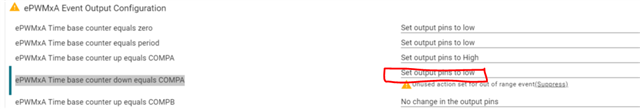

I need to combine two EPWMs with different frequencies together. I could not find in the data sheet their EPWM output circuitry. If I tie them together, the output is not symmetrical, simulation of two pulse generators with 50 Om internal impedances tied together does not show such asymmetry.

First, Assuming your both time periods satisfy=> T(low freq.)= N* T(high freq.) then you can use sync feature on PWMs to have the same rising and falling edges. This removes uneven pulses.

I use syscfg file to set the frequencies. I can send this file if you provide email address. This is PWMs that goes from 0 to VCC. It does not use any modulation just fixed rectangular outputs. "I dont think you have a proper offset for the resultant waveform". how can i set the offset for PWM?

the ePWM uses UP count mode only. where your Action Qualifiers are set wrongly. At CMPA it goes high but it cannot go low at down
you can either use PRD/ZERO to change the AQ state. or else can change to up-down count mode.
