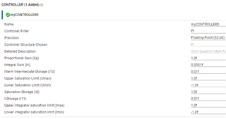

I am using the syscfg for the DCL controller
Please suggest the procedure for updating the this PI controller:
The PI controller running in
interrupt void INT_myADCA_1_ISR(void)
uk = DCL_runPI_C7(&myCONTROLLER0, rk, yk);
and updating as below for kp and ki
void main(void) , write:
  // initialize status update of PI controller
    DCL_resetPI(&myCONTROLLER0);
    DCL_SET_CONTROLLER_PERIOD(& myCONTROLLER0, 0.01f);
    myCONTROLLER0.sps->Kp = 5.0f;
    myCONTROLLER0.sps->Ki = 0.51f;
    DCL_REQUEST_UPDATE(&myCONTROLLER0);
    DCL_updatePI(&myCONTROLLER0);
    DCL_fupdatePI(&myCONTROLLER0);
After including the above line, ADC variables are not updating in expression window. Program is not responding
Please suggest the procedure for updating PI controller parameters.

    My apologies in the delayed response, the problem is with the macro DCL_REQUEST_UPDATE. This macro is misleading since it isn't actually updating anything but rather set a flag that would block the subsequent controller update request. It is meant to be coupled with DCL_CLEAR_UPDATE_REQUEST to protect a program updating the controller from an ISR whilst the SPS parameters are being adjusted.
    Therefore, all you need is either getting rid of DCL_REQUEST_UPDATE or add the macro DCL_CLEAR_UPDATE_REQUEST before calling either DCL_updatePI or DCL_fupdatePI.
    One minor gimmick, DCL_resetPI resets the "immediate storage" that stores previous feedback and saturation values (i6,i10,i11) and it was already initialized in the sysconfig parameters so your first call to DCL_resetPI isn't necessary.
