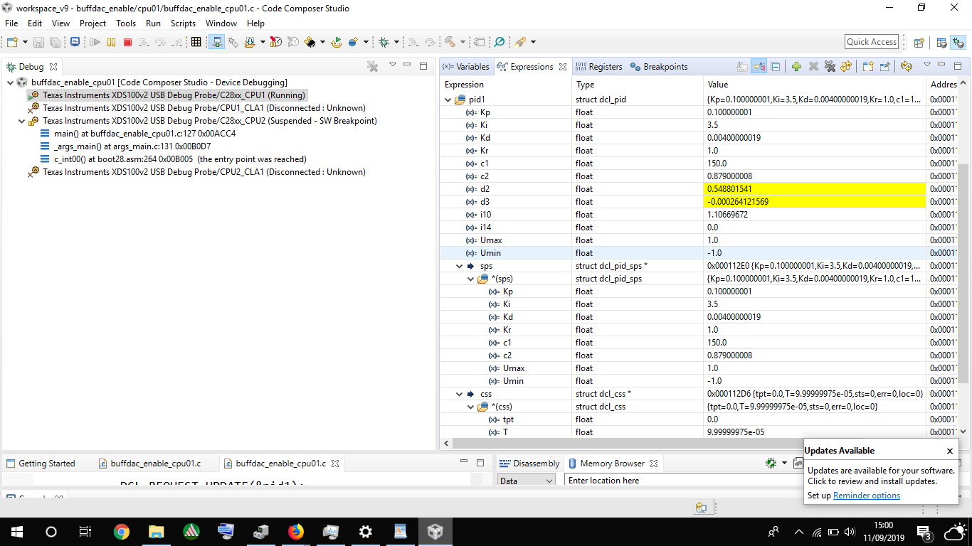

  • Richard,
    Good day,
    I still have difficult. The parameters that stabilize my system are
    kp = 0.5
    ki = 0.1
    kd = 0.02
    However, I changed their values as below in the code, in order to test the DCI_UPDATE, but the parameters do not update in the watch window. Please find below my code:

  • I can only say I see the values being copied over cleanly.  I copied your code verbatim into an empty project.  I place a break-point on this line:
    DCL_REQUEST_UPDATE(&pid1);
    ...then single step to observe the sts bit in the CSS structure change to 1, then single step once more and see the new parameters copy across from the SPS to the main structure (see image below).
    I'm not sure what could be going wrong.  Can you send me a screen shot of your watch window under these conditions please?
    Richard
  • Richard,
    I had a breakpoint on default_pid., but the sts bit in css structure remains 0. How can I single step to observe sts ? Second question, while sts changes, kp, ki and kd should not be changing to new values ??
  • Sorry, when you say "I had a breakpoint on default_pid", which line is that?  I don't see it in the code.
    From your screen capture I can see that c1, c2, Umax, and Umin have copied over correctly.  I cannot see the other values (Kp, Ki, Kd, Kr) - you'd need to scroll up in the watch window.

  • Hi Christian,
    Thank you for the extra screen-shots.  I see you have a break-point set on the update function and have run from there.  I can see the controller parameters in the  SPS and main PID structure are the same, the sts flag is zero so the copy has taken place, and I see d2 and d3 have changed so the controller has run at least once.
    Can you elaborate a little on what the problem is please?  Everything looks OK here, unless I've missed something.  Thanks.
    Richard
  • Richard,
    In my understanding, the DCL_update shall update the PID parameters continuously till stabilizing the system. For instance, in my example, the parameters that stabilize the system are kp = 0,5; ki = 0,1 e kd = 0,04.
    So I was thinking that if I choose random parameters like kp = 0,1; ki = 3,5 e kd = 0,04 (these parameters don't control the system), the DCL_UPDATE function will keep finding new values as long as the system is running.
    However, I think that's not the case, right ?
  • Hi Christian,
    Understand, thanks.
    No, the controller update function doesn't work that way.  It really just updates the main controller structure with whichever parameters are loaded into the STS.  It's left to the user to find suitable coefficients and load them into the SPS, then request the update and call the update function, as you've done in the code:
    DCL_updatePID(&pid1);
    The reason for updating in this way is to ensure the copy takes place when interrupts are disabled, so the controller never runs with a partially updated parameter set.  The DCL doesn't currently have and self-tuning capability.
    Hopefully this clarifies. Let me know if you need anything further.
    Richard
  • Hi Richard,
    Thank you very much.
    BR
