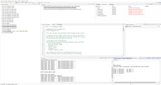

    Ok, that test passes as expected. Could you please try putting your device in wait-boot mode by configuring S3 as shown below?
    Then could you please select View > Target Configurations in CCS?
    Next could you select Launch Target Configuration as shown below?
    Then could you please right click on CPU1 in the debug window, and please select 'Connect Target'?
    Ben Collier
  • That seems to work

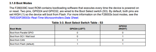

  • Hi Dan,
    I apologize again for the confusion, but I have the sci_ex3_echoback example working fine on my Launchpad after I follow these steps:
    S2: Either set to 0,1 or 0,0
    S3: Either set to 1,1 (default boot to FLASH) or 0,1 (Wait-boot mode)
    There is a problem with using the 'Debug' button for this example. I am not sure why, but I will look into this. For now, we will have to follow the steps that I mentioned in my last response.

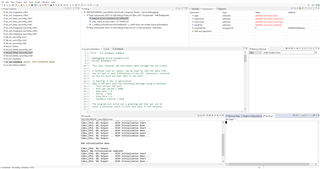

    Please right-click on the sci_ex3_echoback example then click the 'Build Project' option. Please make sure that you have one of the LAUNCH_XL build configurations selected before you build your project.
    Next, right-Click on the TMS320F280039C_LaunchPad.ccxml Target Configuration File, and please select 'Launch Target Configuration'. You can find this by selecting View > Target Configurations and looking in the Projects dropdown. Next, right-click on CPU1 and select 'Connect Target'.
    At this point, your CCS should look like this:
    Next, click on the LOAD button
    Click on 'Browse Project' and select the .out file that you built in the previous steps. Click ok.

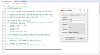

    Click on the terminal button.
    Next, please set up your terminal as mentioned in the introduction to the example. You may have to check your device manager to see which COM port to use.
    At this point, your CCS should look something like this:
    Just click the resume button, and the example should start!
    Please let me know if you are still having trouble with this example after following these steps. Also, there is a similar SCI Lab in C2000 Academy that I would recommend you look at. The Labs in C2000 Academy are similar to the standard C2000WARE examples, but they give much more explanation and they make it easier to learn C2000 Devices.
