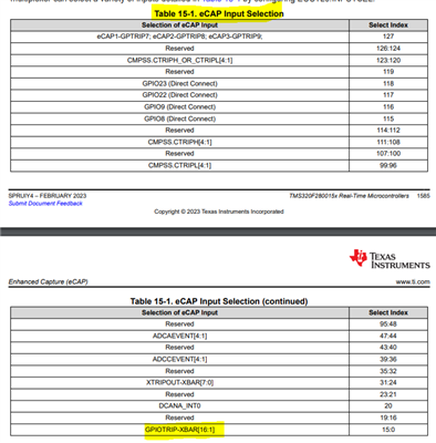

    The following is Table 15-1. eCAP Input Selection from the device TRM section 15.3 Configuring Device Pins for the eCAP;
    Unfortunately, as you can see, there's no direct ePWM connections. However, I've implemented a workaround before where the selected GPIO XBAR input is selected as the output for the desired signal- i.e. ePWMx output to GPIOy, with GPIOy also configured as the Input XBAR input into the eCAPIf the ePWM is already being used as an output, this shouldn't need any additional connections, I believe.

  • Hello Jay,
    The TMS320F2800157 has an additional, highly useful peripheral that I'm referencing- the Input XBAR. Any GPIO can be selected as the input on the Input XBAR, including GPIO30. The eCAP can use any selected Input XBAR as an input. Using this, any GPIO input or output can be measured by the eCAP.
    Therefore, by selecting GPIO30 as Input XBAR 1 (using the Input XBAR register INPUT1SELECT = 30 = 0x1E), then selecting Input XBAR 0 as the input into the eCAP (using the eCAP register ECCTL0[INPUTSEL] = 0x0), GPIO30 can used as the input into the eCAP peripheral.
    The following images (highlighting from me) are from the TMS320F280015x device TRM, linked here.
    Input X-BAR destinations table 10-1
    eCAP Input Selection table 15-1
