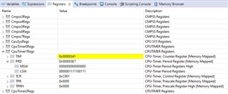

  • Seems like there is something wrong in your project. Please check if the CPU clock, PWM is configured correctly and there is any time overflow in ISR loop.
  • Agree CPUTM0, CPUTM1 appears to be configured correctly. Past checked ISR decimation time 50µs 50% duty cycle, 25µs. Oddly when CPUTM0 didn't divide period count via #define MACRO's it was loading correct period value. Though oscillator MACRO's are mathematically correct by visual inspection USER_SYSTEM_FREQ_MHz.

    Below discovered issue CPUTM0 later CPUTM1 complier warning only when decimal values replace cast integers and Macros, period not equal 1ms. For 1ms clock period load of 0x186A0 or 100,000 decimal. So the value was truncated for 100µs tick of 10,000 load count but compiler did not warn when macro and variable are cast by the caller. I have seen the code Boolean logic work for 1ms tick set CPUTM0 but other parts did not seem to like that slow tick rate.
