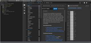

  • Hi Pawan,
    So i created a new project like in the video (C2000 SysConfig: Migrate C2000 Devices in under 10 minutes)
    i am now trying to add the board.
    but it always come back to this (without the board)
    how can i solve this.
    thank you for the support,
    Vincent Beaulieu-Gagnon
  • Hi Vincent,
    Make sure to save your syscfg file after switching to the board support "Control Card F28379xD"
    We also have an updated version of this migration project in this video here:
    https://www.ti.com/video/6327167825112?keyMatch=ONE%20CLICK%20MIGRATINO
    This will be a project that you do not need another project to copy files over but instead can just stick with one project and migrate.

  • Hi Vincent,
    TIDA-010054 is not based on sysconfig but based on powersuite. If you want to migrate to sysconfig based approach, I would recommend below steps.
    1. Use a sysconfig based example from C:\ti\c2000\C2000Ware_5_00_00_00\driverlib\f28004x\examples. Use either the empty project or the universal project.
    2. Copy over all the code from TIDA-010054 non powersuite based example solution. - You will see 2 projects in the solution one is powersuite based and the 2nd non-powersuite based.
    3. Generate initialization code in sysconfig.
    4. Comment off all the conflicting code in the copied files.
    Thanks and regards, Pawan
