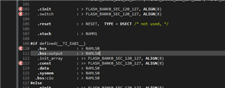

  • Fixed the Flash errors.
    Now I am getting error in RAM
    Please let me know how this can be solved.
    Aman.
  • Aman,
    You can do the same fix for the RAM allocation
    .bss :>> RAMLS0 | RAMLS1
    Best Regards
    Siddharth
  • This does not works.
    Still Same error.
    Aman
