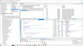

I am trying to make usb_dev_serial example (C:\ti\controlSUITE\device_support\F2837xD\v210\F2837xD_examples_Cpu1)  work on my TMS320F28379D controlCARD.
Everything is operating as expected when I run program from RAM and from FLASH in debug mode. When I program FLASH and start it from debugger the program is running even when debugger is disconnected.
However, if I cycle power after that, the program will not start. The program is not starting on its own without a push from debugger.
I tried to program the Blinky example the same way and the LED is blinking even after power cycle. The SW1 switch settings have not been changed. Both are set to 1.
 Any idea what can cause this behavior and how to troubleshoot it would be appreciated.

    I did a quick check on my LaunchPad, and I see this example boot correctly from flash.  One way you can check this with the emulator running is to perform a debug reset, then before you run, go to "Scripts" and "EMU Boot Select" and pick Boot from flash.  You can then run from the starting ROM address(the debug reset should have brought you there), and the device will behave as it does in standalone boot mode.  If you don't see this reaching your "main" then we can debug more.

  • I took a different board (LAUNCHXL-F28379D) then imported and flashed usb_ex1_dev_serial project from C2000Ware rev 5.0.0. It is actually not simple to verify operation of this project on LAUNCHXL-F28379D as it only has one USB port. I added blinking LED code to this project, and verified the project was working even after power cycle. I then verified same behavior when same project programmed on the original controlCARD. After power cycle the LED is blinking and there is some semblance of serial communication. The serial communication part is not working as well as in the controlCARD example. The serial communication reliability was not part of my original question so we can say that there is issue with the code in controlCARD example and close this support ticket.
    Others seem to have run into the same problem and had to disable watchdog to fix it. Not sure I want to do that.
