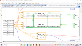

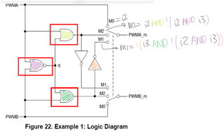

Regarding to the equations, the gate that highlighted by red squares in fig.2 should be a NAND and two ANDs, but it seems like a NOR and two ORs.
Could you please take a look of it?
C:\ti\c2000\C2000Ware_5_00_00_00\driverlib\f2837xd\examples\cpu1\clb
spruir8a_CLB Tool User's Guide (Rev. A) P18 Figure 22. Example 1: Logic Diagram
