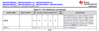

    On my hardware, VREFLO and VREFHI have a capacitor between them, which appears to be the correct hardware configuration as per the F28003x datasheet:
    However, when I measure either side of the VREFHI or VREFLO capacitor to ground, it measures 1.335V and the ADC saturates my measurement to 4095.
    Then I tried something a little weird: I soldered a wire from the VREFLO side to the ground plane, and the ADC now functions 'perfectly'.
    VREFHI measure 1.65V to ground and VREFLO is obviously now grounded.
    And my measurements are now correctly reading my test inputs.
    Except this seems to be wrong... the VREFLO should be tied to ground internally.
    I don't see a way to change the voltage reference itself. The 'ADC_setVREF()' command is tied to each of the 3 ADC modules, not to the voltage reference pin configuration necessarily...
    What could be the issue? I am using the 64PM chip (not PMQ, which has the VREGENZ pin for selecting an external regulator).
    The model stamped onto the chip is "280037CSPM"
    (edit: PMQ, not PMZ)

    Just to be certain, this is the setup/similar to the setup of your VREFHI/VREFLO pins, correct?
    Image taken from the F280039C ControlCard schematic document in C2000Ware. Note that in this schematic, U1 is the F280039C, which is the yellow block in the screenshot.
    Additionally, if that is what your system looks like, what are the contents of the Analog Subsystem registers ANAREFCTL[ANAREF2P5SEL] and ANAREFCTL[ANAREFSEL] ?
    Jason Osborn
  • The original setup only had the 2.2uF capacitor between VREFHI and VREFLO.
    The modified setup that has working ADC measurements is similar to the system.
    I will check those registers right away...
  • Looks like it is correctly set to internal reference at 3.3V:
    All zeros on the register while the program is running, which is internal 3.3V reference mode.
    Odd that the ground reference is needed? I will verify with future boards I set up.
