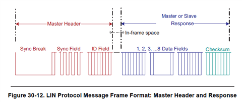

May i know anyway to read out the LIN checksum?
As mentioned in the query here -TMS320F280049: LIN checksum question - C2000 microcontrollers forum - C2000︎ microcontrollers - TI E2E support forums, the checksum error is the only thing that you can get. Since the checksum calculation is hardware based, there is no way you can get the checksum value.
