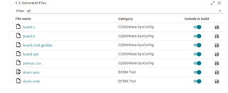

With reference to above post, i am able to configure and program OTP memory using standalone application.
Can we integrate OTP configuration into our existing application so that we can optimise one firmware flashing step ?
Please share reference document to follow.
Prashant Patil
  • Hi Prashant,
    You can do this. Please use sysconfig to generate an example file.
    1) Add a DCSM module.
    2) Do your required settings
    3) Select the generated files dcsm.cmd and dcsm.asm and attach to your project. Or you can use it as template to add to your existing linker command file.
    Thanks and regards, Pawan
