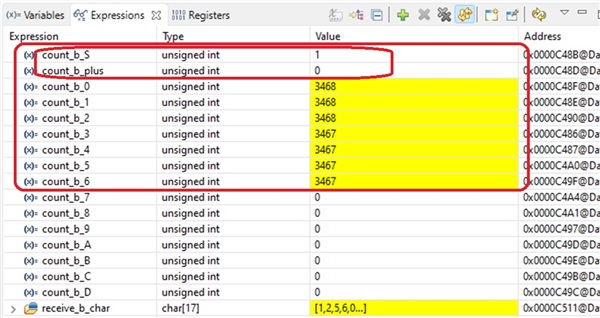

The problem is that I did not get the characters to appear in the right order. Also, when I calculate the appearance of every character in the RX interrupt, I get different values counted. The "S" character seems to appear very frequently compared to others, as shown in the figure.

  • Hi Alif,
    Thanks for your questions.
    This actually looks like you are overrunning the buffer. Can you check the error registers and see if you have a TX overflow? I think what's happening is that you are REPEATEDLY sending data to the TX without waiting for "TXRDY" to be asserted again. Basically, the TX buffer/FIFO is overflowing because you are writing to it faster than the data can send.
    Vince
  • Dear Vince,
    Thank you for your response, by changing the code in TX interrupt, I can make it work for now
    while (ScibRegs.SCIFFTX.bit.TXFFST != 0) {}
    if (ScibRegs.SCICTL2.bit.TXRDY != 0) {
        Uint16 kb;
    	for(kb = 0; kb < 16; kb++) {
    	   ScibRegs.SCITXBUF = sdataB[kb];     // Send data
    	ScibRegs.SCIFFTX.bit.TXFFINTCLR = 1;  // Clear Interrupt flag
    Apparently, it can also use this
    if (ScibRegs.SCIFFTX.bit.TXFFST == 0) { ... }
