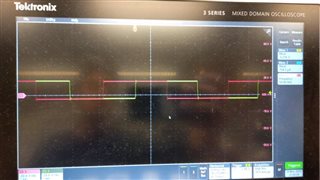

I am trying to write code for my F28379D DSP, but unfortunetly I can not add 180 degree phase shift to my hardware pins even though I have added it in my code. Can anyone please help? Sorry for putting down the code like this below, but the add code option was giving me error when I was adding it there. Please see the code below:

PS_PwmInit(2, 0, 1, 1.e6/(samp*1.0), ePwmUseAB, ePwmResetValleySetPeak, ePwmDoNothingCmp, HRPWM_DISABLE); // pwmNo, pinSel, waveType, period, outtype, PwmA, PWMB, UseHRPwm
PS_PwmSetDeadBand(2, 0, 0, 2, 0, 0, 0);
PS_PwmSetPhaseDelay(2, 1, 180 * (1.0 / 360.0));
PS_PwmSetIntrType(2, ePwmNoAdc, 1, 0);
PS_PwmSetNewTripAction(2, 2, eTzHiZ2, eTzHiZ2, eTzHiZ2, eTzHiZ2);
PWM_CMPA(2) = ((1 - 0) * (1.0 / 1)) * PWM_TBPRD(2);
PSM_PwmStart(2);

PS_PwmInit(5, 0, 1, 1.e6/(samp*1.0), ePwmUseAB, ePwmStartLow1, ePwmComplement, HRPWM_DISABLE); // pwmNo, pinSel, waveType, period, outtype, PwmA, PWMB, UseHRPwm
PS_PwmSetDeadBand(5, 0, 2, 3, 0, 0.2, 0.2);
PS_PwmSetPhaseDelay(5, 1, 180 * (1.0 / 360.0));
PS_PwmSetIntrType(5, ePwmIntrAdc, 1, 0);

Hello Mohammad,
If you haven't looked at some of the EPWM software examples in C2000Ware, those would be a great reference for what you are trying to accomplish (particularly, epwm_ex3_synchronization.c, which implements phase shift in a very basic setup). In the mean time, could you also please let me know a few things to get more insight here:
If you are interested in other resources on implementing phase shift, there is also the EPWM developer's guide and the EPWM video series as well.
Allison
