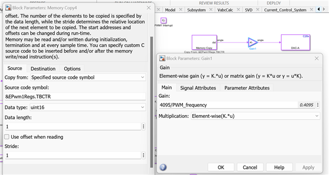

I am using ePWM modules to generate PWM signals. MATLAB/Simulink is what I'm using to program. For use in future calculations, I would like to record my PWM signal. As stated in this (https://e2e.ti.com/support/microcontrollers/c2000-microcontrollers-group/c2000/f/c2000-microcontrollers-forum/1168314/tms320f28379d-list-of-registers-and-memory-addresses-to-be-used-for-memory-copy-block ), I have attempted to copy the TBCTR register and reconstruct the PWM signal. Nevertheless, the memory copy block is not providing me with the correct value for TBCTR. I am using a PWM period of 10kHz/1e-4 seconds. Can the switching states be read from the GPIO data registers? My aim is to access my switching states (PWM signals) for further processing.

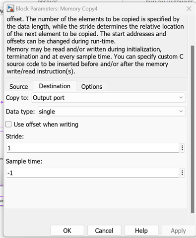

My target value is a symmetrical triangular shape (I am using up-down count mode), what I am getting is shown in the figure below.
ch4 (green) is TBCTR and ch 8 (orange) actual PWM output.
The memory copy block setting is shown below:
