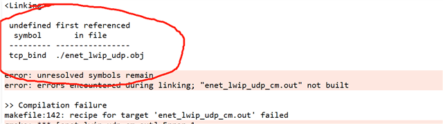

    I saw this file and looks like I can use it. The problem is, for example, I use tcp_bind function in my file and complied it. Error code is like this. I modified the lwip-udp project. Maybe I need to do some more include<>? or modify other files than enet_lwip_udp.c?

  • This is originally in tcp.c so no need to add it into there. I added this in tcp.c and enet_lwip_udp.c and neither works. I found there is no extern err_t udp_bind(struct udp_pcb *pcb, const ip_addr_t *ipaddr, u16_t port) in enet_lwip_udp.c and udp.c but it works. Do you have no idea why?
    In case of UDP,  the macro LWIP_UDP is set to 1 which includes the lwip/udp.h which has a declaration for the udp_bind function.  Hence it is working fine.
    This macro is configured in the lwipopts.h header file .
    There is a similar macro for TCP which needs to be enabled
    #define LWIP_TCP 1
    You can try it out.

  • Hello
    Looks like it works and I can compile it successfully. Thank you for your help. I will try this later to see how to modify it into TCP futher. Will go back to you if there are any questions.
