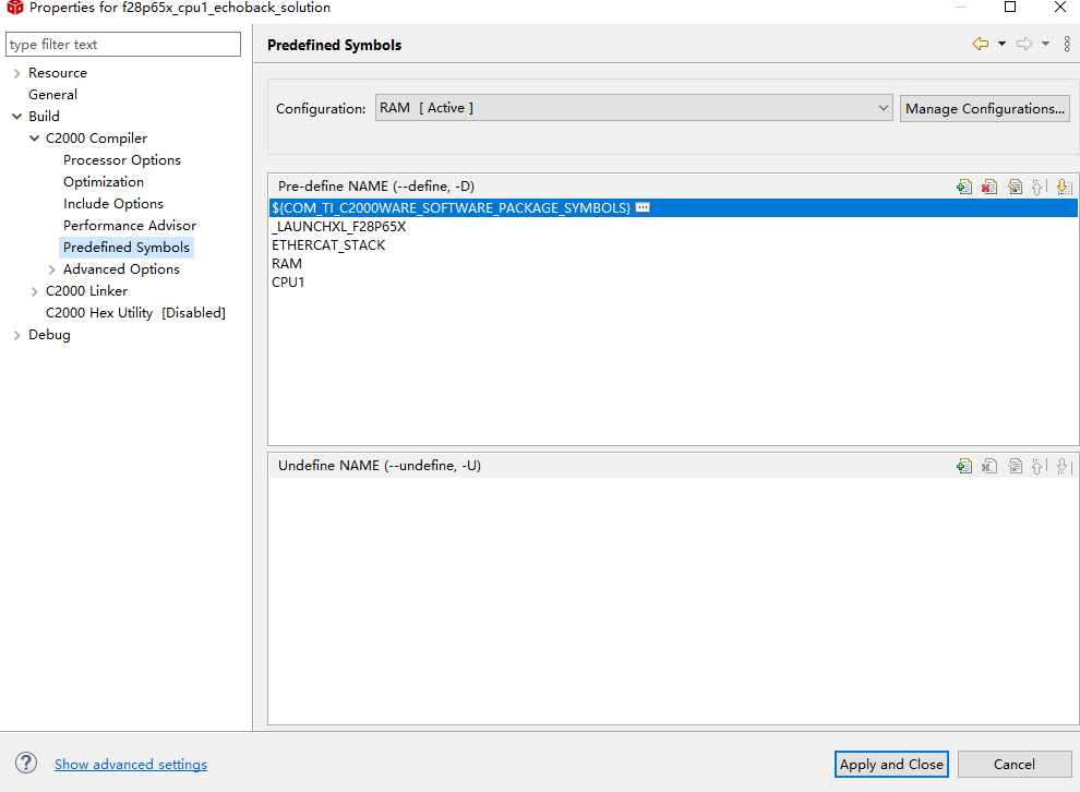

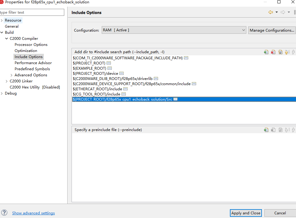

Sample project location:***\C2000Ware_5_01_00_00\libraries\communications\Ethercat\f28p65x\examples\f28p65x_cpu1_echoback_solution
2. Description of the problem
Using the sample project f28p65x_cpu1_echoback_solution, copy the code generated by the SSC to this project directory, and thereafter import the project into CCS and add the _LAUNCHXL_F28P65X macro definition as well as the path to the EtherCAT stack, as shown below:
Compile the above project and following warnings are obtained:
