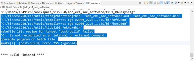

Recently, my customer found out there was two scenario to have different errors with selecting EABI output format on F28003x, to generate the binary format (.bin) output file with the two following commands, the difference is directory separator / \ , highlighted in bold command as below. They are using CCS12.5 version.
"${CCS_INSTALL_ROOT}/utils/tiobj2bin/tiobj2bin" "${BuildArtifactFileName}" "${BuildArtifactFileBaseName}.bin" "C:/ti/ccs1250/ccs/tools/compiler/ti-cgt-c2000_22.6.1.LTS/bin/ofd2000" "${CG_TOOL_ROOT}/bin/hex2000" "${CCS_INSTALL_ROOT}/utils/tiobj2bin/mkhex4bin" (command 1)
"${CCS_INSTALL_ROOT}/utils/tiobj2bin/tiobj2bin" "${BuildArtifactFileName}" "${BuildArtifactFileBaseName}.bin" "C:\ti\ccs1250\ccs\tools\compiler\ti-cgt-c2000_22.6.1.LTS\bin\ofd2000" "${CG_TOOL_ROOT}/bin/hex2000" "${CCS_INSTALL_ROOT}/utils/tiobj2bin/mkhex4bin" (command 2)
I have also duplicated the issue, and got the different error message with two commands in console window in both CCS12.5 and 12.4 version as below snippet.
  (command 1 error : makefile:160: recipe for target 'post-build' failed 'C:' is not recognized as an internal or external command, operable program or batch file.)
  (command 2 error : C28x files built with --abi=eabi are not supported)

So, I have tried to select COFF output format file on F28004x (support both output format), while the error message in Console window was still the same with selecting COFF output format file.
