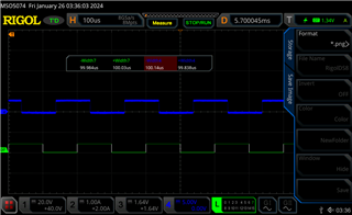

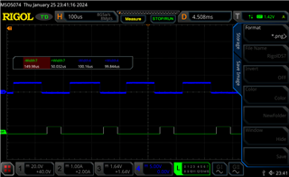

I'm running a simple test of a toggle signal. In blue i send the signal through a DAC, and in green im sending it through the ePWM 4B. im running the card at a frequency of 10kHz and the DAC work as expected with 100us width in the positive and negative section. But the ePWM signal have a negative width of 150us and positive width of 50us. I have already configurated the ePWM propoerly for an Up-Down mode, with shadow register, a load time at counter zero,

  • yes, i was trying to match them in length. A "c" variable was defined (toggle) in the code and got this through the DAC, and using it as the CMPA value for the ePWM4B.
    i already solved the problem, for some reason i had to declare the action "set" when the counter was zero. the action "do nothing" was set by default when the counter was zero, but for some reason it was clearing the value.
    before
    // EPWM4B Positive
    EPwm4Regs.AQCTLB.bit.CBU = AQ_CLEAR; // set actions for EPWM4B
    EPwm4Regs.AQCTLB.bit.CBD = AQ_SET;
    after
    // EPWM4B Positive
    EPwm4Regs.AQCTLB.bit.ZRO = AQ_SET;
