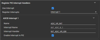

    Returning to my issue, I want to clarify that my architecture is this: the EPWM6 triggers the SOC6 of ADCB, and the related EOC launches the interrupt. Everything configured with SysConfig in CPU1.
    My doubt is, like user6301164 already said in linked question: "When i configure the  pwm1 interrupt in the CPU1 and CPU2, both of them can enter the  pwm1 interrupt. "
    In fact, if I register the same interrupt about ADC in CPU1 in this way:
    It is correctly trigger by both CPU1 and CPU2, but I cannot find a way to avoid the interrupt configuration in CPU1 and configure and use it only in CPU2. Or is it the correct way to manage it? I can leave the CPU1 interrupt empty with just aknowledge it, but it is a sort of workaround for me.
    Moreover, to be clear, the flag "Use Interrupt" is always selected, both when I register and use it only in CPU2 (interrupt KO) and when I register and use in both cores (interrupt OK).
    Thanks again,
    Fabio

  • Hello Fabio,
    So far it seems like you've configured everything correctly. Can we see the output in board.c for when you set it up for CPU1+CPU2 and it works, versus when you configure it for CPU2 only? I'm wondering if a diff of the generated code can give us a clue as to why the CPU2 only case does not work.
    Ibukun
  • Hi Ibukun,
    when I don't register the interrupt with SysConfig in CPU1:
    this is the board.c code:

    and I set "SysCtl_selectCPUForPeripheral(SYSCTL_CPUSEL11_ADC, 2, SYSCTL_CPUSEL_CPU2);" the ADCB1 interrupt cannot be get in CPU2.
    When I register the interrupt with SysConfig in CPU1:

    void INTERRUPT_init(){
    	// Interrupt Setings for INT_ADC_B_1
    	Interrupt_register(INT_ADC_B_1, &INT_ADC_VR_ISR);
    	Interrupt_enable(INT_ADC_B_1);
    	// Interrupt Setings for INT_ADC_A_1
    	Interrupt_register(INT_ADC_A_1, &INT_ADC_ZVS_ISR);
    	Interrupt_enable(INT_ADC_A_1);

    and I can get the interrupt in both cores, CPU1 and CPU2, but I need to avoid to manage it in CPU1.
    Thanks again and regards,
    Fabio
