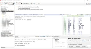

Dear memebers of TI forum,
I was trying to use PI controller in my code, though I was succesfull to link the libraries in the control suite, the controller throws a debug error as below. Additionally, I was also getting some warnings with the C2000 controller, can some experts kindly give some suggesstions, please.
Break at address "0x3ff599" with no debug information available, or outside of program code. "A snapshot is attached herewith for your kinf reference.", it would be great of someone could help me ito resolve the warnings, and the errors in the debug. For your kind information, the console file is also attached.
J.Prasanth Ram
**** Build of configuration Debug for project ADCinterleaved2 ****

  • Kindly find the picture of command file, please.
  • Hi Prasanth,
    Looks like you're trying to test out the F28035 ADC Interrupt example. Is that correct? If so, I would recommend you download our latest SDK, C2000Ware. It has our most up-to-date device support.
    What version of CCS are you using?
    Also looks like one of the warnings is related to a missing path to the location of the IQmath.lib file. I also noticed that you have floating point enabled as part of your build options is that intended?
    Ozino
  • Hello Ozino,
    Thanks for responding. Got some clarity in updating the drivers. I will install the latest version of C2000 ware, and wil try the same.
    Between, I am using the latest CCS 12.6 Version, and one of the warning with IQ math is rectified now.
    Will keep you posted in the thread after trying the code in latest version.
    Many thanks.
    Prasanth Ram
  • Hello Prasanth,
    Sounds good. Please let us know if you have any additional questions.
    Ozino
  • Dear Ozino,
    After trying and updating the C2000 ware, I tried my code with the timer example file. Although, I am being succesful with the errorless code, I have problems in  debugging the code. Somewhere, the code is getting loopep during boot. Howver, I still didint get the problem that where I am going wrong. I also checked with mutlple discussions in the TiE forum, but then, I wasnt able able to figure this out. For your kind reference, I have given my code below, can you kindly chck them once please?
    The screen shot of error during Debug id attched in the picture. your kind suggestions will definitely help me to resolve the problem. Thank you in advance

    The error that you have seems to be related to attempting to halt the debugger in unreachable code. This typically happens when there's protected code included via a library. Is the solar library used pointing to a .lib? If so, this is expected behaviour. You won't be able to actually step through the code that is protected if it is apart of the library.

    After extensive try, I found F28035 controller is not compatible (or) limitation to use FPU32 based libraries. Whenever, I try to call a function with folat 32 variables, I am seeing the symbol mising error in the boot loader (even after adding necessary libraries, this happens only in the debug mode) . Kindly correct me if I am wrong please.
    Prasanth ram
  • Hi Prasanth,
    You're correct that this device does not have built in FPU support on the C28x. Looks like you'll have to leverage the IQmath library. Are you able to migrate to our newer device that has support for FPU?
