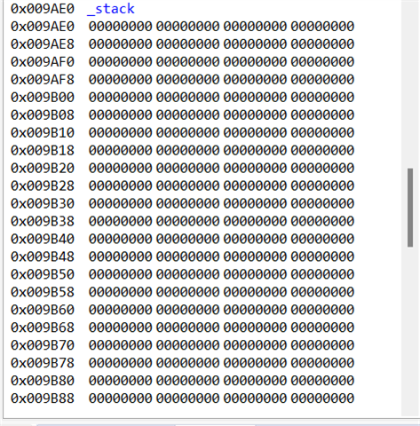

    Here are some screen shots to help answer your questions:
    The address is this case is 0x3FFC02, sometimes it is 0x000000.
    Sandy

    The JTAG expert stated that this is likely not a problem with the debug probe.
    Based on your Disassembly window, it looks like your device reset. Newer devices have a RESC register to help determine the reset cause, but for this device you will need to do some manual checking. Can you please check the status of the XRS pin when the debugger halts? Also, please verify that the power for the device is sequenced correctly according to the datasheet (see section 8.12.2 Power Supply Sequencing for more information):

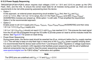

  • I reviewed your schematics. Nothing really stood out as an issue.
    X1/XCLKIN pin is 1.9v level but I see that you have used a series resistor of 20K. I presume you measured the amplitude of the clock signal at X1 pin and that it does not exceed 1.9v.
    There is a note about power-down sequencing in the datasheet. Hope you are meeting this requirement:
    During power-down, the device reset should be asserted low (8 μs, minimum) before the VDD supply reaches
    1.5 V. This will help to keep on-chip flash logic in reset prior to the VDDIO/VDD power supplies ramping down.
    It is recommended that the device reset control from “Low-Dropout (LDO)” regulators or voltage supervisors
    be used to meet this constraint. LDO regulators that facilitate power-sequencing (with the aid of additional
    external components) may be used to meet the power sequencing requirement

  • EMU0/EMU1 pins are used during JTAG debug and to put the device into boundary scan mode. However, all this is applicable only when the -TRST pin is driven high, which only happens the CCS debugger has control of the device. I am unable to determine exactly what state the device is in when you connect EMU1 pin to GND. That would be an extremely noisy event, which might put the device into some indeterminate state.
    Please comment on the power-down sequencing. Can you capture 1.9v, 3.3v and -XRS during powerdown to check if you are meeting the datasheet requirements?
  • Hareesh,
    We are using the TPS76D301 power management chip in the same configuration since 2002.  This chip handles all proper power up/down sequencing.
    purple is 3.3V
    blue is 1.9V
    yellow is XRS
    Thank you for your help!
    Sandy
  • It is evident -XRS goes low several milliseconds before VDD even starts ramping down. I am afraid we have exhausted all debug avenues. You can send a few failing units to us for analysis. That would be the last debug option we could pursue.
  • Sandy,
         I will close this post. If you are sending any devices for failure analysis (FA), that communication can be handled through private messages.
