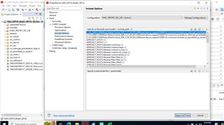

Dear Sir,
How to handle interrupt & How to set interrupt priority.
my priority are highest priority to lowest priority as Timer1->SCI_RX->SCI_TX->PFC_MTRS4_INT.
i have try but facing error those are not resolve so please guide.
for more details please find pic. as below..
for error as below
i have file but still this error occur ,Why?
So Please resolve path issue & interrupt priority.
  • Hi Babaji,
    Instead of including it in there, can you add this in your include options within the project properties to the location of the .h?
    In your code that you call the include header, you'll just need to call
    #include "sw_interrupt_logic.h"
    Ryan Ma
  • Instead of including it in there, can you add this in your include options within the project properties to the location of the .h?
    i Have add but still error occure.
    I have call but still error occure.
    "syscfg\sw_prioritized_isr_levels.h", line 323: fatal error #1965: cannot open source file "device_support\f280013x\common\include\sw_interrupt_prioritization_logic.h"
    1 catastrophic error detected in the compilation of "syscfg/sw_prioritized_defaultisr.c".
    Iif i change the path but after build project then again original path come means no change path.
    every time this path occure:#include "device_support\f280013x\common\include\sw_interrupt_prioritization_logic.h"

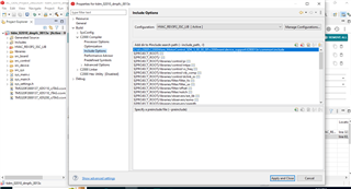

  • Hi Babaji,
    Are you using our C2000WARE example for interrupt_ex3_sw_prioritization this is found within our interrupt examples folder? Can you refer to how the includes are being done in that example and copy it for your project?
    Ryan Ma
  • Are you using our C2000WARE example for interrupt_ex3_sw_prioritization this is found within our interrupt examples folder?
    This example does not used sysconfig file.
    Yes, I have refer but still this error issue not resolved
  • Can you show me your updated project settings? You don't need the sw_priorizied_defualitisr.h in your project, as that is already handled by the include options of where you place it.
    You also don't need to call the path #include "device_support\f280013x\common\include\sw_interrupt_prioritization_logic.h"
    you just need to call #include sw_interrupt_prioritization_logic.h"

  • Are you using the motorcontrol sdk? I cannot build your project since you're using different paths than me.
    Can you remove these files from the project? sw_interrupt_prioritization_logic.h, sw_prioritized_isr_levels.h files.
    These will automatically be included by adding in the include options. Can you update your include options to the below.
    You only need to include the device support\f280013x\common\include once.
    Then try and rebuild.
    i am using this sdk:C:\ti\c2000\C2000Ware_MotorControl_SDK_5_00_00_00\c2000ware
    yes , i have remove
    Yes please check....
    but still error not resolved....

  • Hi Babaji,
    This seems to now be a new error with "Invalid TMU configuration". Are you sure you have the correct TMU configuration in your compiler settings?
    Looks like we've fixed the first issue.
    Ryan Ma

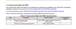

  • Hi Ryan,
    I am Ready to share my code with you, Please check & resolved this issue on priority.
    Please Advise to connect zoom call / Anydesk / Webex call/google meet to resolve this issue.
    I have already share project above.
  • Hi Babaji,
    Can we do one more thing, can you change the TMU configuration to be tmu0? According to our peripheral's guide, F280013x has tmu0.
    Another thing to make sure SysCfg's autogenerated files aren't causing any more issues is to exclude it from your project's build by switching this option within syscfg:
    Ryan Ma
