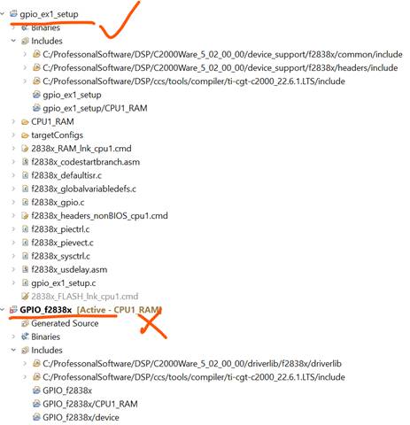

    I've been checking the examples in C2000ware's device support and noticed they work well. Is this because I'm required to use the library in device_support, specifically including headers like "#include 'f2838x_device.h'" and "#include 'f2838x_examples.h'"?
    Previously, I was using the headers "#include 'driverlib.h'" and "#include 'device.h'". Could this change be the cause of my compilation failure? The specific error I encountered is "gmake: *** [main.obj] Error 1". But it will be no problem if I use syntax like "GPIO_setPadConfig()".

    This is likely the cause of the compilation error. Yes, you would need to include #include 'f2838x_device.h'" and "#include 'f2838x_examples.h'" to use bitfield code. Here is an overview of the includes:
    All of the examples in the device_support folder are bitfield examples whereas the examples in the driverlib folder are driverlib examples. They are functionally the same but use different included files and different syntax. Driverlib projects have built-in functions that can be called by source code which configure the necessary registers, whereas bitfield code has to make register accesses manually (like the code you have in your original post). The older devices (like F28335 and F2812) only have bitfield support whereas the newer devices (like F28388, F28377, and F280049 have both bitfield and driverlib support).
    Since F2838x is a newer device, you can write programs using driverlib or bitfield code. For driverlib code, you would need to include "driverlib.h" and "device.h" which contain definitions for the driverlib functions. For bitfield code, you would need to include #include "f28x_project.h" which then includes "f2838x_device.h" and "f2838x_examples.h".
    See the programming guide for more information linked here. Also, when migrating devices it is usually easier to start with the empty_project for that device (from the device_support/[device]/examples/ folder if using bitfield code or from the driverlib/[device]/examples folder if using driverlib code), and copying the code over. This way all of the necessary includes and paths are already set up. Let me know if you have any more questions.
