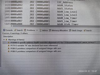

  • Hi,George,
    We are studying the save and update characteristics of LFU
    Define the newly added variable as the update attribute. The other variables are the preserve attribute. Define the TI. update section in the cmd file, provide the old image, and compile it to generate a warning. How can I solve this problem?
    The problem is as follows:
    #10098-D specific address 0xaff5 overlaps with 2 alignment of ". TI. bound: SBALERT-MASK-DEFAULT"
    The map file shows that SBALERT-MASK-DEFAULT has been assigned to the exact address 0xaff5, why is a warning still generated?
    In the cmd file The definition of the TI.update section is as follows:
    The information related to SMBALERT-MASK-DEFAULT in the map file is as follows:

  • Joyce,
    Here's some feedback for your various questions:
    Q1: Are the A and B variables in version 2 preserve or update for version 3 code? If the compilation is completed according to item 1.1, whether the two variables A and B can still maintain the original address and value after the compilation of version 3 is completed;
    It's up to you to decide based on your application whether variables A,B should be update or preserve in any particular firmware versions.
    However, "update" variables from earlier firmware versions should probably be changed to "preserve" for later firmware versions.
    __attribute__(update) indicates the address will move, and the variables will be initialized during warm_init switchover.
    __attribute__(preserve) indicates that address will remain same as prior firmware version and the variables will only be initialized during a cold
    restart
    Q2: Version 3 and Version 2 are available in the cmd file. TI.update section, whether it will affect the RAM address allocation of variables C and D;
    __attribute__(update) variables will always be placed in .TI.update section, however their particular address within that section could change from one
    firmware version to another.
    Q3: 1.2.3 Version 3 code also needs to initialize C.D during __TI_auto_init_warm(), variables A and B are not new variables in version 3 and do not need to be initialized,
    There is a key question here: how do you initialize a new variable?
    1> "Initialize during __TI_auto_init_warm()"—What exactly does this mean?
    In order to initialize a "new" variable in a new firmware version during warm_init switchover, you must mark the variable with __attribute__(update)
    and add .TI.update section to your linker cmd file. The variable is then placed in .TI.update and will get initialized during warm_init switchover.
    In order to keep an existing variable from prior firmware version at the same address (and NOT initialize it during warm_init switchover), you must mark it with __attribute__(preserve)
    Q3.1 Write a new variable in this function to initialize the assignment code ??
    __TI_auto_init_warm() has been defined in the FAPI_F28003x_EABI_v1.58.00.LIB file, and the content of this function cannot be rewritten in code, but can only be called.
    I do not understand above question.
    Q3.2 If the initial value is defined at the same time as the update attribute of the new variable, the compilation error is reported:
    Error code #10472-D SECTION spliting not support for LFU output section "TI,update"
    So what is the specific operation of the sentence "initialize during __TI_auto_init_warm()"?
    Above error indicates you cannot use the splitting placement ">>" for output section .TI.update. Please see spru513 pdf section 8.5.5.7
    Regarding the linker warning about "overrides alignment of 2", please see below bug which we will fix in next patch release:
      https://sir.ext.ti.com/jira/browse/EXT_EP-11487
    Regarding issue with:
    "8 update attribute variables, of which 3 were assigned initial values,
    and the other 5 were not assigned initial values or called operations.
    After compilation, only the three variables with initial values assigned
    to RAM"
    Could you please submit a project so I can reproduce the issue?
    Otherwise I will need more details about each of the 8 variables.
    Regarding your issue with "global variable defined but not called", the compiler may eliminate unused variables. In order to keep them you should mark with retain pragma. See spru514 pdf section 6.9.22
    Greg
