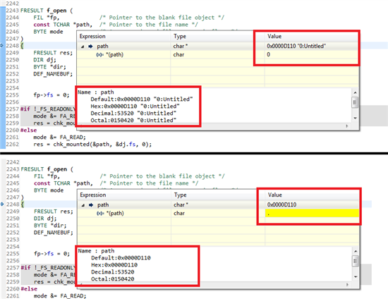

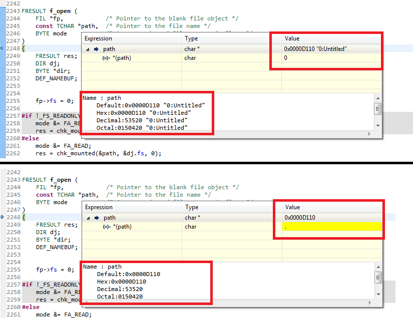

  • Trey,
    I've done some digging and have found some strange behavior. The first time that f_open is called (when the open file functions correctly) all of the proper information is passed to the function. The second time f_open is called is where the oddities occur. Take a look at the picture below. The upper window is a capture of the information as it is passed the first time while the second is what is seen each subsequent time. You can see that the values are the same but lacking the information regarding the file name to be opened. The function call is from the same line of code both times.
    Any ideas on what could possibly going on here? It seems to me like it is more than just a code issue but I'm not an expert.
  • Keith,
    Hrmm.....
    It looks like the pointer to the path string is the same, but the value at said pointer changes.  This leaves two options:
    • something in your code is changing the path and you aren't aware of it (not very likely)
    • there are a lot of deep calls in FatFs which could be over-running the stack and corrupting your path (much more likely)
    Try bumping up your stack size by a few hundred bytes and see if the behavior improves.  Stack size may be adjusted in the build properties, linker options.
    Trey
  • There seems to be some mighty fishy things going on with this program. Let me provide you some information and see if any of this might give you a clue or throw up a red flag.
    First: in order to make the program fit on the chip I was force to edit the linker file to make more room. Seeing that RAML2 wasn't being used by anything, I commented that line out of the linker file and increased the space for RAML1 by 0x1000 (making the total size 0x2000). This provided the space needed for the "code" of the program.
    Second: when running the program, I will always get a successful read of the file the first time it is run. If, within the program, I attempt to call f_open I get the behavior seen above. If I restart the device in the debugger (using the "Restart" button) I get the same results from f_open as if I had already called it once before (valid pointer location with bad data where the pointer is pointing). The only way I can make f_open behave properly is to restart the debugger.
    Finally: I increased the stack memory to 0x600 and moved .stack in the linker command file to RAML6 (not being used by anything else) from RAMM1 and am still getting garbage results. This time I'm at least getting information at the location of the pointer but it's still bad data : "L\261"L\261"L\261". Additionally, I would think that if there was a problem with the stack overflowing that it would be encountered at one of the deeper function calls within FatFS, not at the highest-level function... But maybe I'm missing something?
    Have I messed up the way this device operates by tweaking the linker file or is there something else going on here?
  • Keith,
    No you haven't messed anything up...you just don't fully understand what is going on (and I mean that in the nicest way possible :-)  ).
    1) Good job moving stuff around in the linker file.  Commenting out RAML2 and adding its space to L1 is a perfectly valid way to increase the memory for a section.
    2) This is the KEY!!!!  After restarting the program doesn't work!  This says that the path you are passing is located in RAM and is loaded along with the program by the emulator.  At some point the path data is getting overwritten and then on the next iteration the application fails to run correctly.
    3) 0x600 should be more than enough stack space.  I guess its not a problem with the stack.
    Ok at this point I'd like to see a few things.  Please post your linker command file as well as where you declare and define the path you are calling f_open with.  I'll take a look and then get back to you.
    Trey
