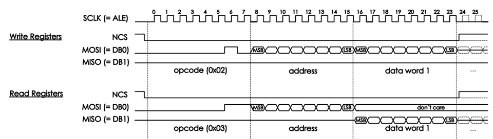

I'm trying SPI communication between TMS320F28388D and MB4 iC. TMS320F28388D works as SPI master, and MB4 works as SPI slave.
The picture below is the MB4 SPI protocol and the OP codes for Register READ/WRITE from the iC MB4 datasheet.
(iC MB4 datasheet download link : https://www.ichaus.de/product/ic-mb4/#documents)

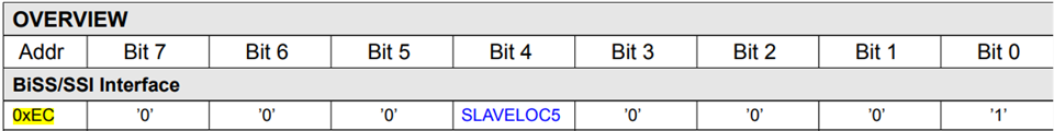

This is the information on the register I want to access to.

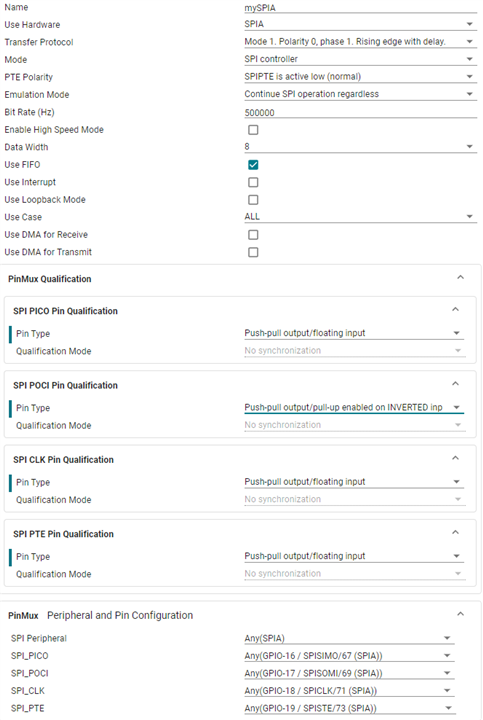

I want to set SLAVELOC5 to 1, so I tried writing 0x10 to the Register with the address 0xEC.

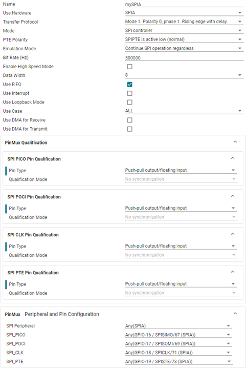

I set the sysconfig and wrote a code to make this SPI protocol. What I did was write 0x10 to the register, and then read the register value.

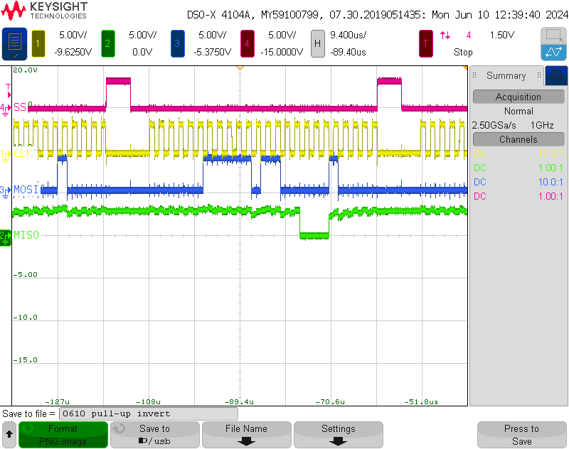

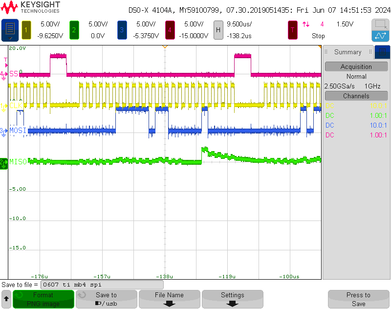

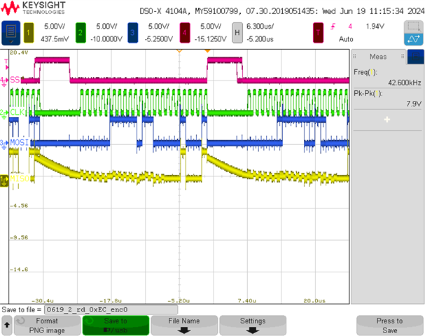

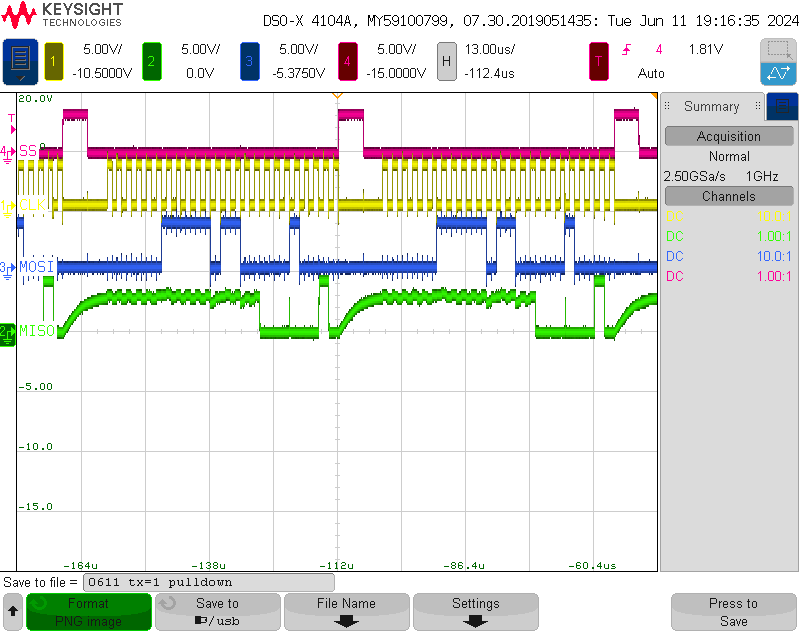

And I got this weird-looking MISO signal.
I first thought that the reason I got this signal was because I only have access to BIT 4 of the register however, writing 0x10 makes it access to other bits of the register as well.
So I also tried writing 0x11(=0b00010001) because I thought it might keep the BIT 0 value to '1'. However, the result was the same.
But I think it's not because the datasheet says that ' Register bits with constant ’0’ or ’1’ are ROM-based values and can not be changed through writing.' and I think writing 0x10 does not change the value of other registers that has values '0'.
And I also tried setting MISO line to 'Push-pull output/pull-up enabled on INVERTED input' as I know this means 'Pull-down'.
But when I set the MISO to pull-down, I got a more weird signal.
The MISO suddenly worked as ACTIVE LOW.

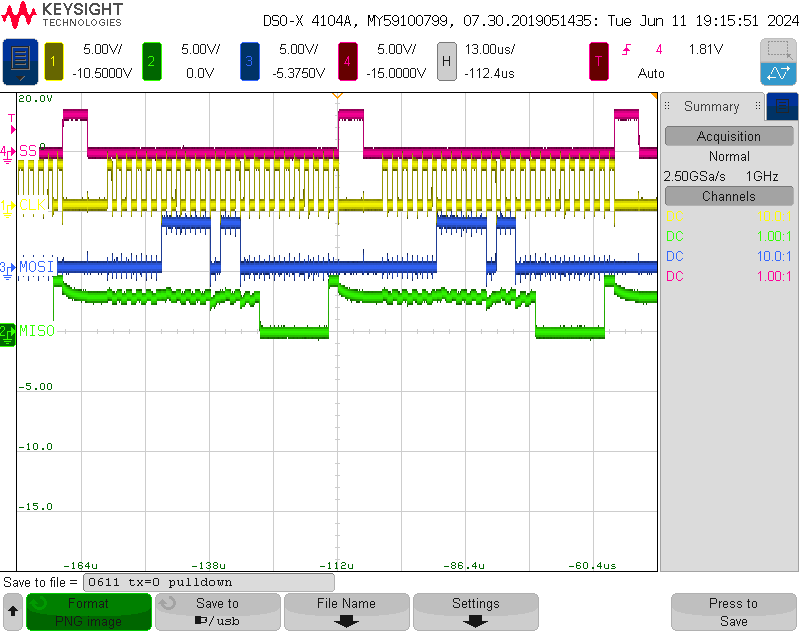

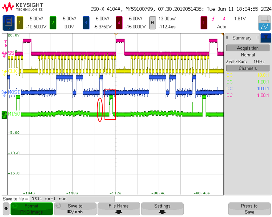

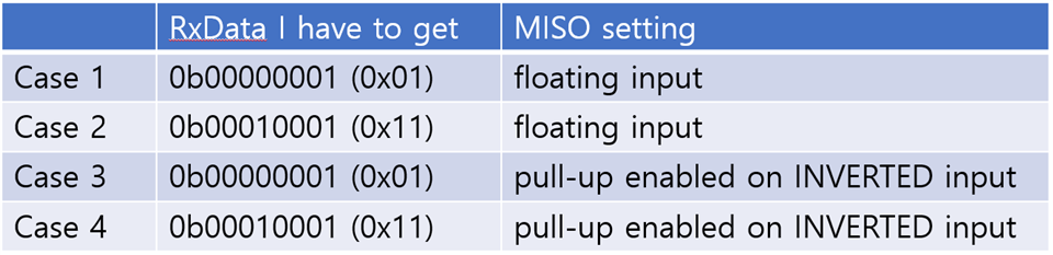

    After I wrote this question I had many different tries for the SPI and discovered something new.
    1. When I set TxData[2] = (uint16_t) (0U << 4); (== TxData[2] = 0;) / MISO 'Push-pull output/floating input'
    The data that has to be written is '0b00000001'.
    The value of the MISO data looks like 0b00000001.
    But the signal's shape goes weird at the end. I'm guessing there is some noise but I cannot guess 'where it is coming from' and 'why it happens'.
    2. When I set TxData[2] = (uint16_t) (1U << 4); (== TxData[2] = 0b00010000;) / MISO 'Push-pull output/floating input'
    The data that has to be written is '0b00010001'.
    But the MISO data's value doesn't look like it is getting 0b00010001. It seems like it is getting 0b00000010.
    I think BIT 4 (circle) looks like it has been triggered, but the signal is not strong enough for some reason. (I don't know if this is the right expression)
    Also, the value '1' must be written in BIT 0 however, it's in BIT 1 (rectangle). I can't even guess why this happened.
    And compared to case 1, the signal is clean and it seems there are no such noises.
    3. When I set TxData[2] = (uint16_t) (0U << 4); (== TxData[2] = 0;) / MISO 'Push-pull output/pull-up enabled on INVERTED input'
    4. When I set TxData[2] = (uint16_t) (1U << 4); (== TxData[2] = 0b00010000;) / MISO 'Push-pull output/pull-up enabled on INVERTED input'
    In cases 3 and 4, setting the MISO line to 'pull-up Invert' makes the signal to HIGH state.
    The value of the MISO data are the same as the cases 1 and 2 each.
    The SPI codes are the same as my first question and I only changed the values and the settings.
    I also organized the cases through the table for a better look.
    I'll be waiting for your reply then.
    Thanks again for your help:)

  • Hi Sumin,
    3. Does 'Push-pull output/pull-up enabled on INVERTED input' mean Pull-down?
    The inverted refers to an inverted polarity on input. Is there a reason you need to qualify the GPIO as such? My recommendation is to leave it as the default and simply modify the SPI polarity and phase settings as needed. Since the second scope shot looks to be "cleaner", I would double check that the polarity and phase of the F2838x SPI and the MB4 SPI as well as other setup configurations matches. The transmission itself looks to be okay, I think.
    Aishwarya

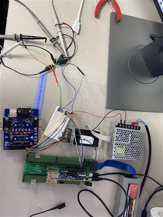

  • Hi Aishwarya,
    I received an email from the TI E2E about the reply that you left about 6 hours ago.
    I don't know why I can't find it online but since I know the contents I will reply here.
    After I received your latest comments I checked my groundings and the circuit between MB4, F28388D, and the scope's probes.
    Each picture below is my circuit for the SPI and its probe, and the circuit schematic I drew.
    I configured the circuits based on informations written in the datasheets.
    The picture below is the pin configuration information of MB4 EVB.
    I've grounded all GND pins of MB4 and F28388D and all the probes to the same GND. As far as I see the groundings of this circuit look fine.
    Am I missing something in this?

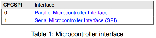

    As far as I know, the settings of the MB4 must be done by F28388D via SPI since it's working as SPI slave.
    SPI settings for MB4 have already been set and I think it cannot be changed because there is no information about the SPI settings of MB4 in the MB4 datasheet.
    The only thing I can change is selecting which interface to activate between 'PPI' and 'SPI'. (Left picture below)
    To activate SPI the CFGSPI must be set to 1, and in the EVB of MB4 by closing JP5 can set the CFGSPI=1. (Right picture below)
    I've checked my MB4 EVBoard and JP5 was in closed state.

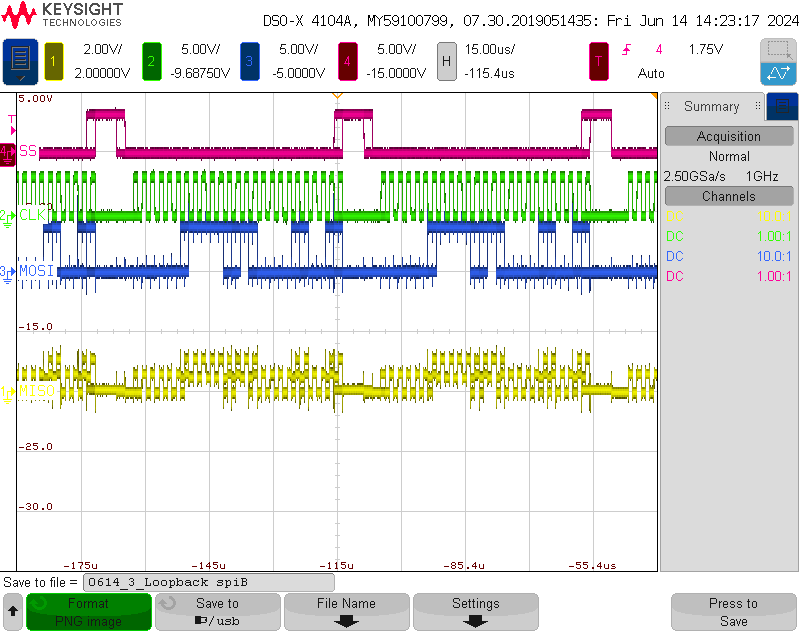

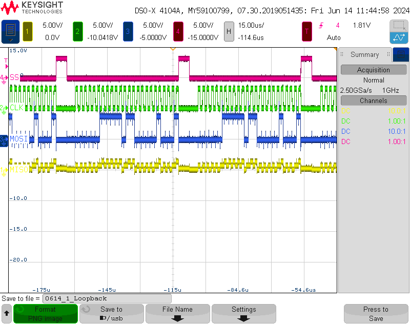

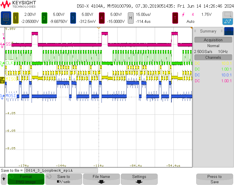

  • Hi Aishwarya,
    I tried the loopback as soon as I read your comment.
    And you were right. The loopback mode also got the MISO signal wrong.
    I got the signal like the picture below. There are no changes in the SPI code and the only change is setting the SPI in the loopback mode.
    The picture on the right has the MISO signal 'scaled up' to 0-2V to 0-5V for a closer look at the signal.
    The weird thing about the MISO signal is,
    1. MISO acts the same as CLK. Since MISO is a data line the timing of the signal up/down should be the same as the MOSI however, you can see that it moves with the same timing with CLK from the picture on the right.
    2. It looks like MISO has a bias. Before the first CLK starts, which means that before SPI starts, its reference of 'LOW STATE' is 0V. But when CLK starts, it acts the same as CLK, and the reference of 'LOW STATE' becomes Afternd after the SPI ends, the reference of 'LOW STATE' becomes 0V again.
    I have no idea why this happens...
    I also tried using a different SPI channel.
    So I changed the SPI channel to SPIB from SPIA.
    The result of MISO was the same.
    And the whole signal seems to be noise about the time axis. Its phase about the time keeps shaking.
    It seems that it has some jitter.
    I wonder,
    1. What is the reason for MISO acting like that?
    2. Why does using SPIB make a noisy signal about the time?
    Sumin
  • Sumin,
    Since the issue is present in loopback mode as well, you can rule out hardware connection issues. The clock schemes seem to be matching as well, but ensure you are setting a MCU SPI clock suitable for the given tSCLK (both), tM (F2838x), and tS (MB4). The values chosen on the controller side looks fine, but make sure the target is configured to this as well. This value should take into account the setup, hold, etc. times. Sometimes operating at too low/high of a clock speed can cause noise. There's also a high-speed mode bit you can use for SPI clocks that are up to 50 MHz for meeting timing requirements better.
    Aishwarya

    Is my conclusion about the loopback right?
    For the time setting, both MB4 and F2838x have a maximum SPI speed of 50MHz so the configuration between the master and slave are the same.
    I set the bit rate to 0.5MHz and I thought it was fast enough.
    But is it not fast enough to make such noise?
  • Sumin,
    Since I set the loopback mode by Sysconfig software, it was loopbacked 'internally' which means that the data will not 'go out' to the GPIO pin of MISO, so it was meaningless for me to probe to the GPIO MISO line.
    You can have a setup that brings the signals out to the pins using an "external" loopback if you wish to scope it.
    Do you see the same noise also at 10 MHz and 20 MHz for example?
    Also, on line 68, why do you have an additional transmit ?
    Aishwarya
  • Hi Aishwarya,
    I also tried it after my recent reply and checked the value in debug mode since the signal will be the same.
    The Rx value got the same value as the Tx.
    When I rechecked the datasheet of the MB4, the maximum value of the CLK was normally 50Mhz but when reading the data the maximum value was 10MHz. So I tested it by changing it to 1MHz and it worked the same as when set to 0.5MHz.
    This is for WRITING the value to the register 0xEC.
    What I wanted to do was WRITE the data, and then READ it back.
    I have a good news!
    I succeeded in transmitting and receiving the data properly!
    The wrong MISO data was because the encoder was not connected to the MB4 ... The hardware is always the problem ...
    I had no idea that such small points like this could cause the problem since my SPI was to access the register that has nothing to do with the encoder.
    I put the MISO data in the variable 'rxData' to see the data from MISO in debug mode.
    Since I wrote '1' in BIT 4 the desired rxData value is 0x11 and the oscilloscope signal and the rxData value both got the right data.
    But there is still an unsolved problem ...
    The signal still goes weird when one SPI transaction ends.
    However, the data value variable received is fine regardless of the weird signal.
    So I wonder,
    1. Why does the signal still look weird?
    2. Is it necessary to solve this signal problem?
    Sumin
  • Sumin,
    I agree, it is always good to triple check the hardware Slight smile  In terms of the signal, this is usually because of an incorrect data receival (software) or data format (configuration). You could check again to make sure the data is being transferred between the TX/RX buffers, SPIDAT, etc. The results might even just be the way the line is being scoped. Also, make sure you are using the latest C2000Ware 5.02 as the PollingNonFIFO function has been changed. (+) TMS320F280025C: Issues with manual control of CS pin in SPI when using driverlib functions
    Aishwarya
