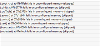

TMS320F2812: HEX2000 unconfigured memory (skipped) issue
Part Number: TMS320F2812
Even though there are a few similar topics raised in the past, I couldn't address my issue.
I see the same issue on either bootloader or application build.
Changing page numbers causes memory issues and build errors.
Here is our bootloader linker layout. The picture above also belongs to bootloader.

  • Is there anyone can help me ?
    Aside from this, I merged bootloader and application .out file into a single .out file which I want to ask you if it would work or not as I don't want to lock memory out the memory during flashing
  • Hi Ismail,
    Can you provide more details on this?
    Let me loop subject experts to comment on this.
    Aswin
  • When I try to change PAGE1 to PAGE 0 of any memory section to make all them in PAGE 0 it gives error saying "Not Available memory region to fit.." The fact is all assignments looked me okay.
    --intel CMD gives at least an .hex output ( I haven't flashed it yet)

  • Thank you,
    to let you know,
    .hex output looks wrong, I am scared of flashing wrong image as it may lockup the device.
    I may support you with any required document if needed.
    .\hex2000.exe --help
    TMS320C2000 Hex Converter v6.4.9
  • Ismail,
    Can you please share the generated .map file when you have the sections mapped to PAGE 0?
    Thanks and regards,
    Charles
                 TMS320C2000 Linker PC v6.4.9
    >> Linked Wed Jun 19 23:33:23 2024
    OUTPUT FILE NAME:   <C:../../bootloader.out>
    ENTRY POINT SYMBOL: "_c_int00"  address: 003d8d17
    MEMORY CONFIGURATION
             name            origin    length      used     unused   attr    fill
    PAGE 0:
      BOOT_START            003d8000   00000002  00000002  00000000  RWIX
      PFLASHIJ              003d8002   00003ff6  00001427  00002bcf  RWIX
      BOOT_CRC              003dbfff   00000001  00000001  00000000  RWIX
      BEGIN                 003f7ff6   00000002  00000002  00000000  RWIX
      ROM                   003ff000   00000fc0  00000000  00000fc0  RWIX
      RESET                 003fffc0   00000002  00000000  00000002  RWIX
      VECTORS               003fffc2   0000003e  00000000  0000003e  RWIX
    PAGE 1:
      RAMM0                 00000000   00000400  00000300  00000100  RWIX
      RAMM1                 00000400   00000400  00000000  00000400  RWIX
      DEV_EMU               00000880   00000180  000000d0  000000b0  RWIX
      FLASH_REGS            00000a80   00000060  00000008  00000058  RWIX
      CSM                   00000ae0   00000010  00000010  00000000  RWIX
      XINTF                 00000b20   00000020  00000020  00000000  RWIX
      CPU_TIMER0            00000c00   00000008  00000008  00000000  RWIX
      CPU_TIMER1            00000c08   00000008  00000008  00000000  RWIX
      PIE_CTRL              00000ce0   00000020  0000001a  00000006  RWIX
      PIE_VECT              00000d00   00000100  00000100  00000000  RWIX
      ECANA                 00006000   00000040  00000034  0000000c  RWIX
      ECANA_LAM             00006040   00000040  00000040  00000000  RWIX
      ECANA_MOTS            00006080   00000040  00000040  00000000  RWIX
      ECANA_MOTO            000060c0   00000040  00000040  00000000  RWIX
      ECANA_MBOX            00006100   00000100  00000100  00000000  RWIX
      SYSTEM                00007010   00000020  00000020  00000000  RWIX
      SPIA                  00007040   00000010  00000010  00000000  RWIX
      SCIA                  00007050   00000010  00000010  00000000  RWIX
      XINTRUPT              00007070   00000010  00000010  00000000  RWIX
      GPIOMUX               000070c0   00000020  00000020  00000000  RWIX
      GPIODAT               000070e0   00000020  00000020  00000000  RWIX
      ADC                   00007100   00000020  0000001a  00000006  RWIX
      EVA                   00007400   00000040  00000032  0000000e  RWIX
      EVB                   00007500   00000040  00000032  0000000e  RWIX
      SCIB                  00007750   00000010  00000010  00000000  RWIX
      MCBSPA                00007800   00000040  00000025  0000001b  RWIX
      RAML0                 00008000   00001000  00000000  00001000  RWIX
      RAML1                 00009000   00001000  00000387  00000c79  RWIX
      EXT_PSRAM             00080000   00010000  00010000  00000000  RWIX
      EXT_PROMLOADER        00090000   00010000  00000000  00010000  RWIX
      EXT_DSRAM             000a0000   00020000  00000000  00020000  RWIX
      CSM_PWL               003f7ff8   00000008  00000008  00000000  RWIX
    SECTION ALLOCATION MAP
     output                                  attributes/
    section   page    origin      length       input sections
    bootstart
    *          0    003d8000    00000002
                      003d8000    00000002     CodeStartBranch_Bootloader.obj (bootstart)
    .text      0    003d8002    00000ec8
                      003d8002    000001dc     tool_specific_hardware.obj (.text)
                      003d81de    000001d6     serial_comm.obj (.text)
                      003d83b4    0000014f     dsp281x_defaultisr.obj (.text:retain)
                      003d8503    00000112     main.obj (.text)
                      003d8615    000000fd     comm.obj (.text)
                      003d8712    000000f5     scib.obj (.text)
                      003d8807    000000ee     scia.obj (.text)
                      003d88f5    000000b1     utils.obj (.text)
                      003d89a6    0000009e     dsp281x_sysctrl.obj (.text)
                      003d8a44    00000099     dsp_crc.obj (.text)
                      003d8add    0000008a     boot_hardware.obj (.text)
                      003d8b67    00000066     timer.obj (.text)
                      003d8bcd    00000062     self_test.obj (.text)
                      003d8c2f    00000052     comcode037.obj (.text)
                      003d8c81    0000004e     comcode038.obj (.text)
                      003d8ccf    00000048     comcode002.obj (.text)
                      003d8d17    00000044     rts2800_ml.lib : boot.obj (.text)
                      003d8d5b    00000033     comcode021.obj (.text)
                      003d8d8e    00000028     dsp281x_piectrl.obj (.text)
                      003d8db6    00000024     comcode000.obj (.text)
                      003d8dda    00000022     dsp281x_pievect.obj (.text)
                      003d8dfc    0000001f     comcode001.obj (.text)
                      003d8e1b    00000019     rts2800_ml.lib : args_main.obj (.text)
                      003d8e34    00000019                    : exit.obj (.text)
                      003d8e4d    00000016     watchdog.obj (.text)
                      003d8e63    00000014     tool_specific_hardware.obj (.text:retain)
                      003d8e77    00000013     can_doubleread.obj (.text)
                      003d8e8a    00000012     comcode070.obj (.text)
                      003d8e9c    0000000b     comcode039.obj (.text)
                      003d8ea7    0000000b     comcode191.obj (.text)
                      003d8eb2    00000009     rts2800_ml.lib : _lock.obj (.text)
                      003d8ebb    00000008     CodeStartBranch_Bootloader.obj (.text)
                      003d8ec3    00000007     comcode008.obj (.text)
    .econst    0    003d8eca    000003ef
                      003d8eca    000001dd     main.obj (.econst:.string)
                      003d90a7    00000001     --HOLE-- [fill = 0]
                      003d90a8    00000100     dsp281x_pievect.obj (.econst)
                      003d91a8    000000bf     serial_comm.obj (.econst:.string)
                      003d9267    0000001f     comcode002.obj (.econst:.string:_$P$T0$1)
                      003d9286    0000001f     comcode002.obj (.econst:.string:_$P$T1$2)
                      003d92a5    00000001     --HOLE-- [fill = 0]
                      003d92a6    00000005     comcode008.obj (.econst:.string)
                      003d92ab    00000001     --HOLE-- [fill = 0]
                      003d92ac    00000001     comcode000.obj (.econst:.string)
                      003d92ad    00000001     --HOLE-- [fill = 0]
                      003d92ae    00000001     comcode001.obj (.econst:.string)
                      003d92af    00000001     --HOLE-- [fill = 0]
                      003d92b0    00000001     comcode037.obj (.econst:.string)
                      003d92b1    00000001     --HOLE-- [fill = 0]
                      003d92b2    00000001     comcode038.obj (.econst:.string)
                      003d92b3    00000001     --HOLE-- [fill = 0]
                      003d92b4    00000001     comcode039.obj (.econst:.string)
                      003d92b5    00000001     --HOLE-- [fill = 0]
                      003d92b6    00000001     comcode070.obj (.econst:.string)
                      003d92b7    00000001     --HOLE-- [fill = 0]
                      003d92b8    00000001     comcode191.obj (.econst:.string)
    .crcTable
    *          0    003d92b9    00000101
                      003d92b9    00000101     dsp_crc.obj (.crcTable)
    .cinit     0    003d93ba    00000057
                      003d93ba    0000002d     comcode002.obj (.cinit)
                      003d93e7    0000000c     serial_comm.obj (.cinit)
                      003d93f3    0000000a     rts2800_ml.lib : exit.obj (.cinit)
                      003d93fd    00000005                    : _lock.obj (.cinit:__lock)
                      003d9402    00000005                    : _lock.obj (.cinit:__unlock)
                      003d9407    00000004     comm.obj (.cinit)
                      003d940b    00000004     main.obj (.cinit)
                      003d940f    00000002     --HOLE-- [fill = 0]
    .pinit     0    003d8002    00000000     UNINITIALIZED
    .switch    0    003d9412    00000018
                      003d9412    00000018     serial_comm.obj (.switch:_serial_MessageWait)
    .boot_crc
    *          0    003dbfff    00000001
                      003dbfff    00000001     boot_crc_val.obj (.boot_crc)
    codestart
    *          0    003f7ff6    00000002
                      003f7ff6    00000002     CodeStartBranch_BootROMEntry.obj (codestart)
    .stack     1    00000000    00000300     UNINITIALIZED
                      00000000    00000300     --HOLE--
    DevEmuRegsFile
    *          1    00000880    000000d0     UNINITIALIZED
                      00000880    000000d0     dsp281x_globalvariabledefs.obj (DevEmuRegsFile)
    FlashRegsFile
    *          1    00000a80    00000008     UNINITIALIZED
                      00000a80    00000008     dsp281x_globalvariabledefs.obj (FlashRegsFile)
    CsmRegsFile
    *          1    00000ae0    00000010     UNINITIALIZED
                      00000ae0    00000010     dsp281x_globalvariabledefs.obj (CsmRegsFile)
    XintfRegsFile
    *          1    00000b20    00000020     UNINITIALIZED
                      00000b20    00000020     dsp281x_globalvariabledefs.obj (XintfRegsFile)
    CpuTimer0RegsFile
    *          1    00000c00    00000008     UNINITIALIZED
                      00000c00    00000008     dsp281x_globalvariabledefs.obj (CpuTimer0RegsFile)
    CpuTimer1RegsFile
    *          1    00000c08    00000008     UNINITIALIZED
                      00000c08    00000008     dsp281x_globalvariabledefs.obj (CpuTimer1RegsFile)
    PieCtrlRegsFile
    *          1    00000ce0    0000001a     UNINITIALIZED
                      00000ce0    0000001a     dsp281x_globalvariabledefs.obj (PieCtrlRegsFile)
    PieVectTableFile
    *          1    00000d00    00000100     UNINITIALIZED
                      00000d00    00000100     dsp281x_globalvariabledefs.obj (PieVectTableFile)
    ECanaRegsFile
    *          1    00006000    00000034     UNINITIALIZED
                      00006000    00000034     dsp281x_globalvariabledefs.obj (ECanaRegsFile)
    ECanaLAMRegsFile
    *          1    00006040    00000040     UNINITIALIZED
                      00006040    00000040     dsp281x_globalvariabledefs.obj (ECanaLAMRegsFile)
    ECanaMOTSRegsFile
    *          1    00006080    00000040     UNINITIALIZED
                      00006080    00000040     dsp281x_globalvariabledefs.obj (ECanaMOTSRegsFile)
    ECanaMOTORegsFile
    *          1    000060c0    00000040     UNINITIALIZED
                      000060c0    00000040     dsp281x_globalvariabledefs.obj (ECanaMOTORegsFile)
    ECanaMboxesFile
    *          1    00006100    00000100     UNINITIALIZED
                      00006100    00000100     dsp281x_globalvariabledefs.obj (ECanaMboxesFile)
    SysCtrlRegsFile
    *          1    00007010    00000020     UNINITIALIZED
                      00007010    00000020     dsp281x_globalvariabledefs.obj (SysCtrlRegsFile)
    SpiaRegsFile
    *          1    00007040    00000010     UNINITIALIZED
                      00007040    00000010     dsp281x_globalvariabledefs.obj (SpiaRegsFile)
    SciaRegsFile
    *          1    00007050    00000010     UNINITIALIZED
                      00007050    00000010     dsp281x_globalvariabledefs.obj (SciaRegsFile)
    XIntruptRegsFile
    *          1    00007070    00000010     UNINITIALIZED
                      00007070    00000010     dsp281x_globalvariabledefs.obj (XIntruptRegsFile)
    GpioMuxRegsFile
    *          1    000070c0    00000020     UNINITIALIZED
                      000070c0    00000020     dsp281x_globalvariabledefs.obj (GpioMuxRegsFile)
    GpioDataRegsFile
    *          1    000070e0    00000020     UNINITIALIZED
                      000070e0    00000020     dsp281x_globalvariabledefs.obj (GpioDataRegsFile)
    AdcRegsFile
    *          1    00007100    0000001a     UNINITIALIZED
                      00007100    0000001a     dsp281x_globalvariabledefs.obj (AdcRegsFile)
    EvaRegsFile
    *          1    00007400    00000032     UNINITIALIZED
                      00007400    00000032     dsp281x_globalvariabledefs.obj (EvaRegsFile)
    EvbRegsFile
    *          1    00007500    00000032     UNINITIALIZED
                      00007500    00000032     dsp281x_globalvariabledefs.obj (EvbRegsFile)
    ScibRegsFile
    *          1    00007750    00000010     UNINITIALIZED
                      00007750    00000010     dsp281x_globalvariabledefs.obj (ScibRegsFile)
    McbspaRegsFile
    *          1    00007800    00000025     UNINITIALIZED
                      00007800    00000025     dsp281x_globalvariabledefs.obj (McbspaRegsFile)
    .ebss      1    00009000    00000387     UNINITIALIZED
                      00009000    00000240     comm.obj (.ebss)
                      00009240    00000100     comcode038.obj (.ebss)
                      00009340    00000024     comcode002.obj (.ebss)
                      00009364    00000010     serial_comm.obj (.ebss)
                      00009374    00000008     self_test.obj (.ebss)
                      0000937c    00000004     rts2800_ml.lib : exit.obj (.ebss)
                      00009380    00000002                    : _lock.obj (.ebss:__lock)
                      00009382    00000002                    : _lock.obj (.ebss:__unlock)
                      00009384    00000002     tool_specific_hardware.obj (.ebss)
                      00009386    00000001     main.obj (.ebss)
    .boot_loader
    *          1    00080000    00010000     UNINITIALIZED
                      00080000    00010000     boot_hardware.obj (.boot_loader)
    .reset     0    003fffc0    00000002     DSECT
                      003fffc0    00000002     rts2800_ml.lib : boot.obj (.reset)
    vectors    0    003fffc2    00000000     DSECT
    CsmPwlFile
    *          1    003f7ff8    00000008     UNINITIALIZED
                      003f7ff8    00000008     dsp281x_globalvariabledefs.obj (CsmPwlFile)
    GLOBAL DATA SYMBOLS: SORTED BY DATA PAGE
    address     data page           name
    00000000       0 (00000000)     __stack
    00000880      22 (00000880)     _DevEmuRegs
    00000a80      2a (00000a80)     _FlashRegs
    00000ae0      2b (00000ac0)     _CsmRegs
    00000b20      2c (00000b00)     _XintfRegs
    00000c00      30 (00000c00)     _CpuTimer0Regs
    00000c08      30 (00000c00)     _CpuTimer1Regs
    00000ce0      33 (00000cc0)     _PieCtrlRegs
    00000d00      34 (00000d00)     _PieVectTable
    00006000     180 (00006000)     _ECanaRegs
    00006040     181 (00006040)     _ECanaLAMRegs
    00006080     182 (00006080)     _ECanaMOTSRegs
    000060c0     183 (000060c0)     _ECanaMOTORegs
    00006100     184 (00006100)     _ECanaMboxes
    00007010     1c0 (00007000)     _SysCtrlRegs
    00007040     1c1 (00007040)     _SpiaRegs
    00007050     1c1 (00007040)     _SciaRegs
    00007070     1c1 (00007040)     _XIntruptRegs
    000070c0     1c3 (000070c0)     _GpioMuxRegs
    000070e0     1c3 (000070c0)     _GpioDataRegs
    00007100     1c4 (00007100)     _AdcRegs
    00007400     1d0 (00007400)     _EvaRegs
    00007500     1d4 (00007500)     _EvbRegs
    00007750     1dd (00007740)     _ScibRegs
    00007800     1e0 (00007800)     _McbspaRegs
    00009000     240 (00009000)     _gBusCOM
    00009040     241 (00009040)     _gRxBuffer
    0000937c     24d (00009340)     ___TI_cleanup_ptr
    0000937e     24d (00009340)     ___TI_dtors_ptr
    00009380     24e (00009380)     __lock
    00009382     24e (00009380)     __unlock

    This is original form of .map file where all sections mapped to PAGE0. It gives unconfigured memory issue. Application image has also same issue.
    Btw, I had to rename some namings due to the confidentiality issue.
  • Ok, thanks Ismail. Is there a need for bootstart vs. codestart?
  • It looks we don't need.
    This is build command we used, for the application, it is the same one.
    ${C2000_CG_ROOT}/bin/hex2000 ${PROJECT_ROOT}/../bootloader.out -m -romwidth 16 -o ${PROJECT_ROOT}/../bootloader.srec --exclude=bootstart --exclude=csm_rsvd --exclude=codestart --exclude=csm_password
  • Hi Ismail,
    I see, so is the 'codestart' being excluded so that you can start in the dissassembly?
    Does the same issue occur if you build the combined .out using a different outfile generation, like .txt file?
    Charles
  • I am afraid, don’t understand first question correctly.
    I only tried intel hex and binary outputs which give the same issue. Would you like me to do?
  • Hi Ismail,
    For the first question, I'm assuming by the build commands you are using that you wish to exclude the 'codestart' symbol?
    Is it possible for you to try/use .txt as an output?
    Thanks and regards,
    Charles
  • To your first question, yes.
    For the second one, It gives the same issue..
  • Hi Ismail,
    Ok, can you describe to me the version of CCS you are using to generate this project?
    On a separate note, is it possible to migrate this project to one of our newer devices? Our newer devices are more powerful and have more features, often at a lesser cost. You can find suggestions for functionally-compatible newer devices in the device homepage, under the title "Similar products you might be interested in". We have also published several migration guides to help you migrate to our newer devices.
    Thanks and regards,
    Charles
  • Ok, can you describe to me the version of CCS you are using to generate this project?
    CCS V12.
    Ahh Charles..  No way Slight smile
    I don't know why .srec output is working fine compared to others.
    Can I merge bootloader and application .srec files?
  • I'm mostly sure the discussion in this forum thread applies to this one too.
    Thanks and regards,
    -George
  • https://e2e.ti.com/support/microcontrollers/c2000-microcontrollers-group/c2000/f/c2000-microcontrollers-forum/1380265/tms320f2812-flashing-images-over-dslite
    I opened up another thread which I resolved my issue here.
    As I had managed creating .srec output before raising this ticket, I've flashed in this format.
