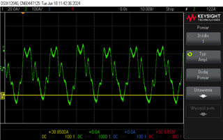

I'm in charge of design and program 3 phase inverter for embeded PMSM motor apliccation.
I have an issue regarding non sinusoidal phase current whih looks like below:
Few years ago Julio has similar issue which was related to compiler v6.2.0 with some bug regarding math function.
Jorge Zambada told about that, and after compiler version change phase current looks properly.
We use a compiler v22.6.1.LTS, is this possible that this problem stil occur?
Thank you for a help!
  • Hi Dawid,
    Which project are you encountering this issue in?
    Kind regards,
    Skyler
  • I'm working on lab05b from instaspin labs.
    We have custom made pcb. MCU is TMS320f28066, Mosfet driver is: Infineon 6EDL7141 driver and mosfet transistors are IAUS240N08 4 in parallel.

    //! \brief It is recommended to start with a value ~3x greater than the USER_ADC_FULL_SCALE_VOLTAGE_V and increase to 4-5x if scenarios where a Bemf calculation may exceed these limits
    //! \brief This value is also used to calculate the minimum flux value: USER_IQ_FULL_SCALE_VOLTAGE_V/USER_EST_FREQ_Hz/0.7
    #define USER_IQ_FULL_SCALE_VOLTAGE_V      (120.0)   // 24.0 Example for boostxldrv8301_revB typical usage and the Anaheim motor
    // ~twice the max measure value
    //! \brief Defines the maximum voltage at the input to the AD converter <<< for phase voltages >>>
    //! \brief The value that will be represented by the maximum ADC input (3.3V) and conversion (0FFFh)=(4095)=(2^12-1)
    //! \brief Hardware dependent, this should be based on the voltage sensing and scaling to the ADC input
    #define OLD_USER_ADC_FULL_SCALE_VOLTAGE_V  (60.59167)    //for 3.3 V internal
    #define USER_ADC_FULL_SCALE_VOLTAGE_V      (55.08334)    //for 3.0 V external
    // voltage divider: 100k and 5.76k multiplied by max measurement voltage
    //! \brief Defines the maximum voltage at the input to the AD converter  <<< for DC bus voltage >>>, V
    #define OLD_USER_ADC_FULL_SCALE_DC_VOLTAGE_V  (65.58922)   //for 3.3 V internal
    #define USER_ADC_FULL_SCALE_DC_VOLTAGE_V      (59.62651)   //for 3.0 V external
    // voltage divider: 470k and 24.9k multiplied by max measurement voltage
    //! \brief Defines the full scale current for the IQ variables, A
    //! \brief All currents are converted into (pu) based on the ratio to this value
    //! \brief WARNING: this value MUST be larger than the maximum current readings that you are expecting from the motor or the reading will roll over to 0, creating a control issue
    #define OLD_USER_IQ_FULL_SCALE_CURRENT_A  (550.0)  // 20.0 Example for boostxldrv8301_revB typical usage // current sense 64
    #define USER_IQ_FULL_SCALE_CURRENT_A      (550.0) // 20.0 Example for boostxldrv8301_revB typical usage // current sense 32
    //! \brief Defines the maximum current at the AD converter
    //! \brief Hardware dependent, this should be based on the current sensing and scaling to the ADC input
    #define OLD_USER_ADC_FULL_SCALE_CURRENT_A  (515.625)    // 33.0 boostxldrv8301_revB current scaling, for current sense 64, for 3.3 V internal
    #define USER_ADC_FULL_SCALE_CURRENT_A      (469)      // 33.0 boostxldrv8301_revB current scaling, for current sense 32, for 3.0 V external
    // no voltage divider, R = 2x parallel 0.0001 ohms = 0.00005 ohms,
    // measured current I gives U = Uoffset + k*R*I at AD converter
    // measured current 937.5 A gives U = 1.5 V + 32*(0.00005 * 937.5 A) = 3.0 V
    // old: gain of the MOSFET driver = 64, offset 3.3 V/2 (should be, but it is 2.5V now)
    // old: i.e. 3.3 V = 515.625 A
    //! \brief Defines the number of current sensors used
    //! \brief Defined by the hardware capability present
    //! \brief May be (2) or (3)
    #define USER_NUM_CURRENT_SENSORS          (3)  // 3 Preferred setting for best performance across full speed range, allows for 100% duty cycle
    //! \brief Defines the number of voltage (phase) sensors
    //! \brief Must be (3)
    #define USER_NUM_VOLTAGE_SENSORS          (3) // 3 Required
    //! \brief ADC current offsets for A, B, and C phases
    //! \brief One-time hardware dependent, though the calibration can be done at run-time as well
    //! \brief After initial board calibration these values should be updated for your specific hardware so
    //! \brief they are available after compile in the binary to be loaded to the controller
    #define   I_A_offset    (0.0) //(0.8331743479)
    #define   I_B_offset    (0.0) //(0.8355930448)
    #define   I_C_offset    (0.0) //(0.8392037153)
    //! \brief ADC voltage offsets for A, B, and C phases
    //! \brief After initial board calibration these values should be updated for your specific hardware so they are available after compile in the binary to be loaded to the controller
    #define   V_A_offset    (0.0) //(0.5271264911)
    #define   V_B_offset    (0.0) //(0.5257175565)
    #define   V_C_offset    (0.0) //(0.5249399543)
    //! \brief CLOCKS & TIMERS
    //! \brief Defines the Pulse Width Modulation (PWM) frequency, kHz
    //! \brief PWM frequency can be set directly here up to 30 KHz safely (60 KHz MAX in some cases)
    //! \brief For higher PWM frequencies (60 KHz+ typical for low inductance, high current ripple motors) it is recommended to use the ePWM hardware
    //! \brief and adjustable ADC SOC to decimate the ADC conversion done interrupt to the control system, or to use the software Que example.
    //! \brief Otherwise you risk missing interrupts and disrupting the timing of the control state machine
    #define USER_PWM_FREQ_kHz             (16.0) //30.0 Example, 8.0 - 30.0 KHz typical; 45-80 KHz may be required for very low inductance, high speed motors
    //#define USER_PWM_FREQ_kHz                (10.0)
    //! \brief Defines the maximum Voltage vector (Vs) magnitude allowed.  This value sets the maximum magnitude for the output of the
    //! \brief Id and Iq PI current controllers.  The Id and Iq current controller outputs are Vd and Vq.
    //! \brief The relationship between Vs, Vd, and Vq is:  Vs = sqrt(Vd^2 + Vq^2).  In this FOC controller, the
    //! \brief Vd value is set equal to USER_MAX_VS_MAG*USER_VD_MAG_FACTOR.  Vq = sqrt(USER_MAX_VS_MAG^2 - Vd^2).
    //! \brief Set USER_MAX_VS_MAG = 0.5 for a pure sinewave with a peak at SQRT(3)/2 = 86.6% duty cycle.  No current reconstruction is needed for this scenario.
    //! \brief Set USER_MAX_VS_MAG = 1/SQRT(3) = 0.5774 for a pure sinewave with a peak at 100% duty cycle.  Current reconstruction will be needed for this scenario (Lab10a-x).
    //! \brief Set USER_MAX_VS_MAG = 2/3 = 0.6666 to create a trapezoidal voltage waveform.  Current reconstruction will be needed for this scenario (Lab10a-x).
    //! \brief For space vector over-modulation, see lab 10 for details on system requirements that will allow the SVM generator to go all the way to trapezoidal.
    #define USER_MAX_VS_MAG_PU        (0.5)    // Set to 0.5 if a current reconstruction technique is not used.  Look at the module svgen_current in lab10a-x for more info.
    //! \brief DECIMATION
    //! \brief Defines the number of pwm clock ticks per isr clock tick
    //!        Note: Valid values are 1, 2 or 3 only
    #define USER_NUM_PWM_TICKS_PER_ISR_TICK        (3)
    //#define USER_NUM_PWM_TICKS_PER_ISR_TICK        (1)
    //! \brief Defines the number of isr ticks (hardware) per controller clock tick (software)
    //! \brief Controller clock tick (CTRL) is the main clock used for all timing in the software
    //! \brief Typically the PWM Frequency triggers (can be decimated by the ePWM hardware for less overhead) an ADC SOC
    //! \brief ADC SOC triggers an ADC Conversion Done
    //! \brief ADC Conversion Done triggers ISR
    //! \brief This relates the hardware ISR rate to the software controller rate
    //! \brief Typcially want to consider some form of decimation (ePWM hardware, CURRENT or EST) over 16KHz ISR to insure interrupt completes and leaves time for background tasks
    #define USER_NUM_ISR_TICKS_PER_CTRL_TICK       (1)      // 2 Example, controller clock rate (CTRL) runs at PWM / 2; ex 30 KHz PWM, 15 KHz control
    //! \brief Defines the number of controller clock ticks per current controller clock tick
    //! \brief Relationship of controller clock rate to current controller (FOC) rate
    #define USER_NUM_CTRL_TICKS_PER_CURRENT_TICK   (1)      // 1 Typical, Forward FOC current controller (Iq/Id/IPARK/SVPWM) runs at same rate as CTRL.
    //! \brief Defines the number of controller clock ticks per estimator clock tick
    //! \brief Relationship of controller clock rate to estimator (FAST) rate
    //! \brief Depends on needed dynamic performance, FAST provides very good results as low as 1 KHz while more dynamic or high speed applications may require up to 15 KHz
    #define USER_NUM_CTRL_TICKS_PER_EST_TICK       (1)      // 1 Typical, FAST estimator runs at same rate as CTRL;
    //! \brief Defines the number of controller clock ticks per speed controller clock tick
    //! \brief Relationship of controller clock rate to speed loop rate
    #define USER_NUM_CTRL_TICKS_PER_SPEED_TICK  (16)   // 15 Typical to match PWM, ex: 15KHz PWM, controller, and current loop, 1KHz speed loop
    //! \brief Defines the number of controller clock ticks per trajectory clock tick
    //! \brief Relationship of controller clock rate to trajectory loop rate
    //! \brief Typically the same as the speed rate
    #define USER_NUM_CTRL_TICKS_PER_TRAJ_TICK   (16)   // 15 Typical to match PWM, ex: 10KHz controller & current loop, 1KHz speed loop, 1 KHz Trajectory
    //! \brief LIMITS
    //! \brief Defines the maximum negative current to be applied in Id reference
    //! \brief Used in field weakening only, this is a safety setting (e.g. to protect against demagnetization)
    //! \brief User must also be aware that overall current magnitude [sqrt(Id^2 + Iq^2)] should be kept below any machine design specifications
    #define USER_MAX_NEGATIVE_ID_REF_CURRENT_A     (-0.5 * USER_MOTOR_MAX_CURRENT)   // -0.5 * USER_MOTOR_MAX_CURRENT Example, adjust to meet safety needs of your motor
    //! \brief Defines the R/L estimation frequency, Hz
    //! \brief User higher values for low inductance motors and lower values for higher inductance
    //! \brief motors.  The values can range from 100 to 300 Hz.
    #define USER_R_OVER_L_EST_FREQ_Hz (300)               // 300 Default
    //! \brief Defines the low speed limit for the flux integrator, pu
    //! \brief This is the speed range (CW/CCW) at which the ForceAngle object is active, but only if Enabled
    //! \brief Outside of this speed - or if Disabled - the ForcAngle will NEVER be active and the angle is provided by FAST only
    #define USER_ZEROSPEEDLIMIT   (0.5 / USER_IQ_FULL_SCALE_FREQ_Hz)     // 0.002 pu, 1-5 Hz typical; Hz = USER_ZEROSPEEDLIMIT * USER_IQ_FULL_SCALE_FREQ_Hz
    //! \brief Defines the force angle frequency, Hz
    //! \brief Frequency of stator vector rotation used by the ForceAngle object
    //! \brief Can be positive or negative
    #define USER_FORCE_ANGLE_FREQ_Hz   (2.0 * USER_ZEROSPEEDLIMIT * USER_IQ_FULL_SCALE_FREQ_Hz)      // 1.0 Typical force angle start-up speed
    // defined in this way makes: 2*x*y where x=0.5/y, so 2*x*y=2*0.5/y*y = 1.0
    //! \brief POLES
    //! \brief Defines the analog voltage filter pole location, Hz
    //! \brief Must match the hardware filter for Vph
    #define USER_VOLTAGE_FILTER_POLE_Hz  (580)
    //should be > USER_IQ_FULL_SCALE_FREQ_Hz / 4 = 75 Hz for 300 Hz.
    //previously it was R = 100kohms, C = 100nF, 1/(2piRC) = 15.92 Hz
    //modified now to 580 Hz!
    //! \brief USER MOTOR & ID SETTINGS
    // Choose only one motor below :)
    //#define LETRIKA_A_010310
    #define KOMEL
    #if defined LETRIKA_A_010310
        #define USER_MOTOR_TYPE                 MOTOR_Type_Pm // Motor_Type_Pm (All Synchronous: BLDC, PMSM, SMPM, IPM) or Motor_Type_Induction (Asynchronous ACI)
        #define USER_MOTOR_NUM_POLE_PAIRS       (4)    // PAIRS, not total poles. Used to calculate user RPM from rotor Hz only
        #define USER_MOTOR_Rr                   (NULL) // Induction motors only, else NULL
        #define USER_MOTOR_Rs                   (0.00778)     // Identified phase to neutral resistance in a Y equivalent circuit (Ohms, float)
        #define USER_MOTOR_Ls_d                 (0.00003315)  // For PM, Identified average stator inductance  (Henry, float)
        #define USER_MOTOR_Ls_q                 (0.00003315)  // For PM, Identified average stator inductance  (Henry, float)
        #define USER_MOTOR_RATED_FLUX           (0.080714) //Identified TOTAL flux linkage between the rotor and the stator (Webers = Volts* Seconds).
        #define USER_MOTOR_MAGNETIZING_CURRENT  (NULL) // Induction motors only, else NULL
        #define USER_MOTOR_RES_EST_CURRENT      (1.0)  // During Motor ID, maximum current (Amperes, float) used for Rs estimation, 10-20% rated current
        #define USER_MOTOR_IND_EST_CURRENT      (-1.0) // During Motor ID, maximum current (negative Amperes, float) used for Ls estimation, use just enough to enable rotation
        #define USER_MOTOR_MAX_CURRENT          (3.0)  // CRITICAL: Used during ID and run-time, sets a limit on the maximum current command output of the provided Speed PI Controller to the Iq controller
        #define USER_MOTOR_FLUX_EST_FREQ_Hz     (15.0) // During Motor ID, maximum commanded speed (Hz, float), ~10% rated
        #define IPD_HFI_EXC_FREQ_HZ             (750.0) // excitation frequency, Hz
        #define IPD_HFI_LP_SPD_FILT_HZ          (35.0)  // lowpass filter cutoff frequency, Hz
        #define IPD_HFI_HP_IQ_FILT_HZ           (100.0) // highpass filter cutoff frequency, Hz
        #define IPD_HFI_KSPD                    (15.0)  // the speed gain value
        #define IPD_HFI_EXC_MAG_COARSE_PU       (0.13)  // coarse IPD excitation magnitude, pu
        #define IPD_HFI_EXC_MAG_FINE_PU         (0.12)  // fine IPD excitation magnitude, pu
        #define IPD_HFI_EXC_TIME_COARSE_S       (0.5)   // coarse wait time, sec max 0.64
        #define IPD_HFI_EXC_TIME_FINE_S         (0.4)   // fine wait time, sec max 0.4
        #define AFSEL_FREQ_HIGH_PU              (_IQ(15.0 / USER_IQ_FULL_SCALE_FREQ_Hz))
        #define AFSEL_FREQ_LOW_PU               (_IQ(10.0 / USER_IQ_FULL_SCALE_FREQ_Hz))
        #define AFSEL_IQ_SLOPE_EST              (_IQ((float)(1.0/0.1/USER_ISR_FREQ_Hz)))
        #define AFSEL_IQ_SLOPE_HFI              (_IQ((float)(1.0/10.0/USER_ISR_FREQ_Hz)))
        #define AFSEL_IQ_SLOPE_THROTTLE_DWN     (_IQ((float)(1.0/0.05/USER_ISR_FREQ_Hz)))
        #define AFSEL_MAX_IQ_REF_EST            (_IQ(0.6))
        #define AFSEL_MAX_IQ_REF_HFI            (_IQ(0.6))
        #define USER_MOTOR_FREQ_LOW             (0.0)           // Hz - suggested to set to 10% of rated motor frequency
        #define USER_MOTOR_FREQ_HIGH            (253.3333333)   // Hz - suggested to set to 100% of rated motor frequency
        #define USER_MOTOR_FREQ_MAX             (300.0)         // Hz - suggested to set to 120% of rated motor frequency
        #define USER_MOTOR_VOLT_MIN             (0.0)           // Volt - suggested to set to 15% of rated motor voltage
        #define USER_MOTOR_VOLT_MAX             (48.0)          // Volt - suggested to set to 100% of rated motor voltage
    #elif defined KOMEL
        #define USER_MOTOR_Rs                   (0.0042)     // Identified phase to neutral resistance in a Y equivalent circuit (Ohms, float)
        #define USER_MOTOR_Ls_d                 (0.0000594)  // For PM, Identified average stator inductance  (Henry, float)
        #define USER_MOTOR_Ls_q                 (0.000152)  // For PM, Identified average stator inductance  (Henry, float)
        #define USER_MOTOR_RATED_FLUX           (0.09069)  //Identified TOTAL flux linkage between the rotor and the stator (Webers = Volts* Seconds).
        #define USER_MOTOR_RES_EST_CURRENT      (20.0)  // During Motor ID, maximum current (Amperes, float) used for Rs estimation, 10-20% rated current
        #define USER_MOTOR_IND_EST_CURRENT      (-20.0) // During Motor ID, maximum current (negative Amperes, float) used for Ls estimation, use just enough to enable rotation
        #define USER_MOTOR_MAX_CURRENT          (350.0)  // CRITICAL: Used during ID and run-time, sets a limit on the maximum current command output of the provided Speed PI Controller to the Iq controller
        #define USER_MOTOR_FLUX_EST_FREQ_Hz     (30.0) // During Motor ID, maximum commanded speed (Hz, float), ~10% rated
        #define IPD_HFI_HP_IQ_FILT_HZ           (1000.0) // highpass filter cutoff frequency, Hz
        #define USER_MOTOR_FREQ_HIGH            (133.0)     // Hz - suggested to set to 100% of rated motor frequency
        #define USER_MOTOR_FREQ_MAX             (200.0)     // Hz - suggested to set to 120% of rated motor frequency
    #elif defined KOMEL_OLD
        #define USER_MOTOR_Rs                   (0.0021)     // Identified phase to neutral resistance in a Y equivalent circuit (Ohms, float)
        #define USER_MOTOR_RATED_FLUX           (0.1285982)  //Identified TOTAL flux linkage between the rotor and the stator (Webers = Volts* Seconds).
        #define USER_MOTOR_MAX_CURRENT          (200.0)  // CRITICAL: Used during ID and run-time, sets a limit on the maximum current command output of the provided Speed PI Controller to the Iq controller
    #else
        #error No motor defined.
    #endif
    #ifndef USER_MOTOR_TYPE
    #error The motor type is not defined in user.h
    #endif
    #ifndef USER_MOTOR_NUM_POLE_PAIRS
    #error Number of motor pole pairs is not defined in user.h
    #endif
    #ifndef USER_MOTOR_Rr
    #error The rotor resistance is not defined in user.h
    #endif
    #ifndef USER_MOTOR_Rs
    #error The stator resistance is not defined in user.h
    #endif
    #ifndef USER_MOTOR_Ls_d
    #error The direct stator inductance is not defined in user.h
    #endif
    #ifndef USER_MOTOR_Ls_q
    #error The quadrature stator inductance is not defined in user.h
    #endif
    #ifndef USER_MOTOR_RATED_FLUX
    #error The rated flux of motor is not defined in user.h
    #endif
    #ifndef USER_MOTOR_MAGNETIZING_CURRENT
    #error The magnetizing current is not defined in user.h
    #endif
    #ifndef USER_MOTOR_RES_EST_CURRENT
    #error The resistance estimation current is not defined in user.h
    #endif
    #ifndef USER_MOTOR_IND_EST_CURRENT
    #error The inductance estimation current is not defined in user.h
    #endif
    #ifndef USER_MOTOR_MAX_CURRENT
    #error The maximum current is not defined in user.h
    #endif
    #ifndef USER_MOTOR_FLUX_EST_FREQ_Hz
    #error The flux estimation frequency is not defined in user.h
    #endif
    // the functions
    //! \brief      Sets the user parameter values
    //! \param[in]  pUserParams  The pointer to the user param structure
    extern void USER_setParams(USER_Params *pUserParams);
    //! \brief      Checks for errors in the user parameter values
    extern void USER_checkForErrors(USER_Params *pUserParams);
    //! \brief      Gets the error code in the user parameters
    //! \return     The error code
    extern USER_ErrorCode_e USER_getErrorCode(USER_Params *pUserParams);
    //! \brief      Sets the error code in the user parameters
    //! \param[in]  errorCode    The error code
    extern void USER_setErrorCode(USER_Params *pUserParams,const USER_ErrorCode_e errorCode);
    //! \brief      Recalculates Inductances with the correct Q Format
    //! \param[in]  handle       The controller (CTRL) handle
    extern void USER_softwareUpdate1p6(CTRL_Handle handle);
    //! \brief      Updates Id and Iq PI gains
    extern void USER_calcPIgains(CTRL_Handle handle);
    //! \brief      Computes the scale factor needed to convert from torque created by Ld, Lq, Id and Iq, from per unit to Nm
    //! \return     The scale factor to convert torque from (Ld - Lq) * Id * Iq from per unit to Nm, in IQ24 format
    extern _iq USER_computeTorque_Ls_Id_Iq_pu_to_Nm_sf(void);
    //! \brief      Computes the scale factor needed to convert from torque created by flux and Iq, from per unit to Nm
    //! \return     The scale factor to convert torque from Flux * Iq from per unit to Nm, in IQ24 format
    extern _iq USER_computeTorque_Flux_Iq_pu_to_Nm_sf(void);
    //! \brief      Computes the scale factor needed to convert from per unit to Wb
    //! \return     The scale factor to convert from flux per unit to flux in Wb, in IQ24 format
    extern _iq USER_computeFlux_pu_to_Wb_sf(void);
    //! \brief      Computes the scale factor needed to convert from per unit to V/Hz
    //! \return     The scale factor to convert from flux per unit to flux in V/Hz, in IQ24 format
    extern _iq USER_computeFlux_pu_to_VpHz_sf(void);
    //! \brief      Computes Flux in Wb or V/Hz depending on the scale factor sent as parameter
    //! \param[in]  sf           The scale factor to convert flux from per unit to Wb or V/Hz
    //! \return     The flux in Wb or V/Hz depending on the scale factor sent as parameter, in IQ24 format
    extern _iq USER_computeFlux(CTRL_Handle handle, const _iq sf);
    //! \brief      Computes Torque in Nm
    //! \param[in]  torque_Flux_sf  The scale factor to convert torque from (Ld - Lq) * Id * Iq from per unit to Nm
    //! \param[in]  torque_Ls_sf    The scale factor to convert torque from Flux * Iq from per unit to Nm
    //! \return     The torque in Nm, in IQ24 format
    extern _iq USER_computeTorque_Nm(CTRL_Handle handle, const _iq torque_Flux_sf, const _iq torque_Ls_sf);
    //! \brief      Computes Torque in lbin
    //! \param[in]  torque_Flux_sf  The scale factor to convert torque from (Ld - Lq) * Id * Iq from per unit to lbin
    //! \param[in]  torque_Ls_sf    The scale factor to convert torque from Flux * Iq from per unit to lbin
    //! \return     The torque in lbin, in IQ24 format
    extern _iq USER_computeTorque_lbin(CTRL_Handle handle, const _iq torque_Flux_sf, const _iq torque_Ls_sf);
    #ifdef __cplusplus
    #endif // extern "C"
    //@} // ingroup
    #endif // end of _USER_H_ definition
  • Hi Dawid,
    Have you taken a look at the User Guide for any relevant info? The subject matter expert is currently out of office, so please expect some delay in responses.
    Kind regards,
    Skyler
