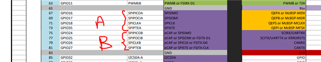

Is there a document or other reference to explain how the GPIO pins are mapped?
I have SPIA module setup to control me device A, and the default pins on Docking Station Board are
SPISIMOA - 67
SPISOMIA - 69
SPICLKA - 71
SPISTEA - 73
All works so far!
Now I created SPIB wanting to control device B by MCU board. What the pins that should output SPIB signals on the Docking Station?
How to configure and how the pin numbers on the board drawing corresponds to GPIOxxx definitions in the header files?
Is there a way to map SPIA outputs to different pins on the board? What is the process?
I am new to MCU programming, so give as much details as possible, so I can follow and succeed with my project.
Thanks, Sergey.
  • Hi Sergey,
    Please refer the pinout for TMDSCNCD28P65X EVM.  pinout_p65x
    You should already have access to both SPI-A and SPI-B pins on the controlcard at these location. Ideal way is to use the SPI functionality at these specified pins, if you are using controlcard for your application.
    Otherwise, you need to route those SPI pins to another GPIO locations, but we need to check if those pins are available over XBAR which is little complex.
