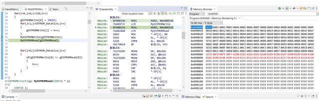

I have a breakpoint set at a function call.  When stopped at the breakpoint, clicking Run does not restart execution, I have to click Stepover and then click run. Odd problem so I made a video.
https://youtu.be/tqlLLmlxSF4?si=8OO-oGwOqo6BCJnq
I have a breakpoint set at MyEEPROMWrite().  I click Run several times but execution stays at the same line.  When I click StepOver MyEEPROMWrite() executes, the data in the Memory window updates and execution moves to the next line.  Clicking run now runs the rest of the loop and stops at MyEEPROMWrite() and the behavior repeats.

    Can you send some screenshots of the disassembly? What happens after you press play in the dissembly view? Does this behavior occur every time you load the program and debug?
    Ryan Ma
  • First screenshot is before and after clicking run.  There is no change.
    This is after clicking stepover.  Notice that data in memory browser has changed indicating that EEPROMWrite() was called.
    This is appears to happen every time I load and debug the project.
