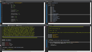

I have a CLA set up and I'd like to use a structure that I define in a different library within my program to do floating point math.
However, I don't know exactly how to declare the variables or get the headers/CLA to properly reference each other so they see the structure.
In the below picture, I have the #pragma DATA_SECTION() statement with a structure as defined below. I have a .h that has the typedef for this structure, and I have an extern statement that should bring in the structure here from the outside. The error that I get when I build is that the PID_struct, as shown in the bottom left, in the .h, is not defined.
I must be missing something that allows me to use a structure defined in another .h file in the CLA.
