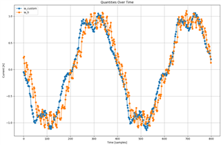

Our observations:
1. Using torque control mode with Iq setpoint higher than 170A, the estimated RPM differs from real measured RPM with external optical sensor. Setting the setpoint higher does not further increase the RPM.

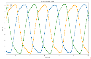

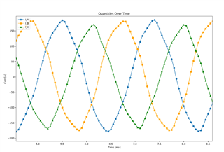

2.Currents and voltages sampled on all three phases look good around the 170A Iq setpoint. But if the setpoint is set higher reaching some point things go crazy and distortion is visible on current and also on angle estimation. The same happens when we try to push RPM higher in speed control mode.

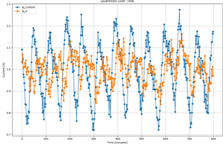

3.Iq current seems to oscillate more than expected (captured in torque control mode with Iq step from 5 to 10A).
We of course also tried to tune PI parameters of the current regulators, but it had no significant effect on oscillations.
