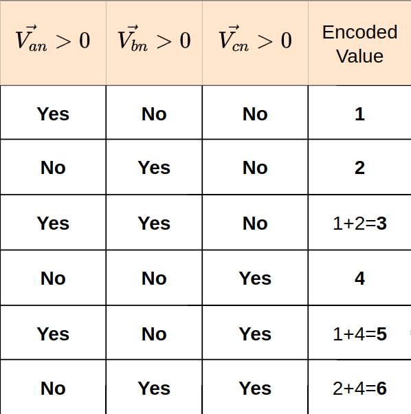

I made this table (sector is initialized as 0):

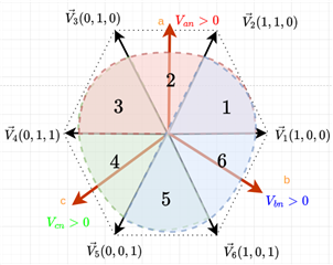

The regions where Va is positive, could be denoted by a semi-circle that's aligned with the phase-a vector. I have tried to visualize the regions as such:
And when only Va>0, according to the table the sector should be 1, but it's actually in the 2nd sector,
When Va>0, and Vb>0, it should be sector 3, and that it is.
Yea, I am confused.

  • I think I have figured it out. Two corrections first of all:
    1. I have arranged the abc-vectors in the negative phase-sequence, so that adds to the confusion. Code has been prepared according the positive phase-sequence, which is the standard representation.
    2. The regions where each Va Vb and Vc is positive, will actually be aligned with the diagonals of the hexagon. The semicircle's 180 degrees will perfectly align with the 180 degrees of the 3 sectors of the hexagon, like so:
    One can see why the inverse clarke has been modified to add a shift of 90 degrees, much more clearly now.
    The sector-determination algorithm doesn't directly give us the sectors. It gives us numbers, which we then map to sectors. I made this table, with the help of the diagram (based on the modified inverse clarke-transform) :
    This step is not clear in the code, as the encoded values of the sectors are directly taken into the switch-statement. So the encoded sector 1 in the switch-case statement, actually has the dwell periods for sector-2. Encoded sector 5, will have the dwell periods of sector-3. One can verify this by going through the DMC_Soft_Lib_Documentation, page 201.
    Edit: t2 for sector-3 is actually "-Y"
