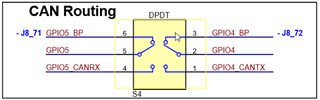

    Upon reviewing the TRM (TMS320F280015x Real-Time Microcontrollers), we noticed that the default  TX/RX CAN pins for the microcontroller using CAN BOOT Mode are GPIO7 and GPIO5 respectively (Table 5-36). However, in the documentation for the LaunchPad (C2000 F280015x Series LaunchPad Development Kit, section 3.1.5). GPIO4 and 5 are routed to the transceiver.
    Do you think this might be causing the CAN communication issue indicated by the RED light during data transfer (during both application and kernel transfer)? To overcome this, we attempted to run the MCU in emulation mode by changing the register values as follows:

    I have confirmed with the team that this is a known issue with F280015x Launchpads. I am creating a ticket to have a clear statement added in the user guide. This is due to the exact reasoning you mentioned. GPIO4/5 are routed to the transceiver but GPIO7/5 is used by the bootloader.
    The procedure you have followed otherwise is correct.

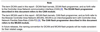

    1. When you refer to the CAN-FD boot, do you mean the MCAN flash kernel implementation given in the document (Application Note: CAN Flash Programming of C2000 Microcontrollers)? In that case, if you refer to section 5, "TMS320F2800157" is NOT mentioned as a supported device.
    Moreover, the said flash kernel is also not available in the C2000Ware, maybe you could please provide some clarification on this. (Although, please note that the file named 'flash_kernel_ex5_dcan_flash_kernel.c' has the title in the comments as 'TITLE:   MCAN Flash Kernel Example for F280015x', which might be a mistake).
    Yes, CAN-FD and MCAN are used interchangeably in that application note.
    The can_flash_programmer found in C2000Ware is for MCAN boot and dcan_flash_programmer is for CAN boot.
    Unfortunately, we don't offer an MCAN flash kernel example for F280015x devices, only a CAN/DCAN flash kernel.
    You have two possible options (physical or software modification required) if you wish to use CAN or CAN-FD boot on an F280015x LaunchPad:
    1. You can short GPIO7 (CANTXA) and GPIO5 (CANRXA) directly to the on-board CAN Transceiver & Connector, and use CAN boot. The CAN expert is out of office until next week, but I can provide more details if you're interested in this method. From the schematic:
    2. You can attempt CAN-FD boot using the can_flash_programmer with the "-d f28p55x" flag, as well as modifying the F280015x DCAN flash kernel to use CAN-FD peripheral communication. No physical modification to the LaunchPad is necessary.

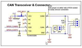

  • Hi Taif,
    From the F280015x LaunchPad Schematic:
    You'll have to make the following connections to S4 for GPIO7 to replace GPIO4 in the routing to the CAN transceiver:
    1. Solder GPIO5 (J8_71) to GPIO5_CANRX
    2. Solder GPIO7 (J8_77) to GPIO4_CANTX
    3. Leave CAN routing switch as set in schematic (to BP)
      1. This will ensure GPIO4 is disconnected
    Matt

    Thank you for your previous help. After implementing your suggested hardware modifications, we can confirm the PCAN-USB Pro's LED is now blinking green during the flash kernel download using the dcan_flash_programmer.

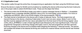

    Lastly, after generating the flash kernel txt file, open it in a text editor and change bytes 3-4 to be “C0 7A”. These bytes contain metadata to configure the bitrate of the CAN bus.
    Here's an example:
    As per the CAN Flash Programming Guide:
    Why "C0 7A"? These values correspond to the following CAN_CALC settings found in bootloader_can_timing.h:
