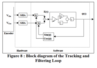

    Are you having some type of inductive / magnetic position sensor with sin/cos feedback for 1 cycle per revolution? In this case, you only need to bring these two signals to ADC and do a PLL / ATAN type of decoding for the position information.
    Han
  • Hello Han,
    yes, it is a magnetic encoder with only one sin cos wave cycle per revolution.
    I implemented it similar to the sin/cos library. What do you mean by PLL? (is this instead of ATAN?)
    I found this in a paper, but I’m not exactly sure what you mean: (www.analog.com/.../452913422000_sin_encoder.pdf)
    I also found a thread, on a PLL for a resolver in this thread: https://e2e.ti.com/support/microcontrollers/c2000-microcontrollers-group/c2000/f/c2000-microcontrollers-forum/1265821/tms320f28388d-back-to-question-on-parameters-used-for-resolver-i-f-in-digital-power-sdk-project-tidm-02009/4867154?tisearch=e2e-sitesearch&keymatch=PLL%2520AND%2520resolver%2520AND%2520motor#4867154
    Is there an advantage using this method? Do you have any resources or references for additional information on this topic?
    This is how I implemented it in Matlab so far, every turn, I look for the max an min values of the sin cos waves to calculate the offset. This is my basic idea, what do you say about this?
    Then I subtract the offset and calculate the angle with atan2. I will add an amplitude correction later.
