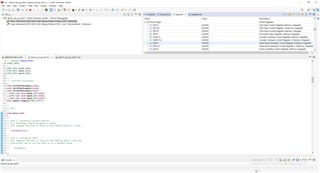

  • Hello Nguyen,
    The attached image shows the execution of the epwm_up_aq_cpu01 example from C2000Ware using the F28377S board in Real-Time Mode through Target Configurations.
    As you explained, even after pressing Continuous Refresh, the EPWM1 register values do not update and remain at 0x0000.
    I would greatly appreciate any advice you could provide to resolve this issue.
    Thank you for your time and consideration.
    Seungsoo Kim
  • Hi Seungsoo Kim,
    Thanks for checking the registers. To clarify, at what point in the code are you checking the registers? Can you please use the "step over" button or set a breakpoint after the lines of code that initialize the EPWM timebase registers and send a screen capture of this?
    Also, it looks like you are viewing the "expressions" window. Can you please send a snippet of the "Registers" window with the EPWM6 registers expanded and viewable?
    Right now, the EPWM registers you sent are completely empty, meaning perhaps you are configuring a different EPWM or looking at the registers of a different EPWM, you are checking the registers before running through the init, or there is something else going on we need to look into.
    Allison

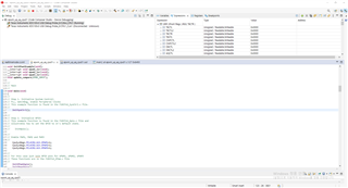

  • Hi Allison
    The previous screenshot I posted was captured after performing the following steps:
    Target Configurations → Launch Selected Configuration → Connect Target → Enable Silicon Real-Time Mode → Resume.
    Additionally, the attached screenshot was taken using the same method, but this time with the Registers window open for better visibility.
    Furthermore, when I try to use the Step Over button, the debugger switches to a window displaying the message:
    "Break at address '0x3ff16e' with no debug information available, or outside of program code."
    Due to this, I am unable to proceed with the Step Over function.
    Seungsoo Kim
  • Hi Seungsoo Kim,
    When you load the program, does CCS halt at the start of your main() function still? Since you are unable to step through your code, I'm having doubts that your code is running through the initializations properly - that would also explain why you don't see your EPWM getting configured.
    The message you see in the debug window means that the CPU has gone to an address in the bootrom (0x3ff16a) as indicated by the device memory map found within the F2837xS datasheet (below) - likely in some ITRAP.
    Can you please run the unmodified C2000ware example and first just make sure you can load and step over the device initializations and see the registers change correctly (no need to scope the pins if you do not have access to them). I want to establish this as a baseline and ensure your setup is working.
    Allison

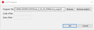

  • Hi Allison,
    After building the unmodified C2000Ware example, I specified the epwm_up_aq_cpu01.out file in the Debugging window using the following steps:
    Run → Load → Load Program → Select epwm_up_aq_cpu01.out file
    After clicking Resume, a blue block appeared next to the main() function line in the code, as shown in the attached screenshot. (The blue block is only present at the main() function.)
    Does this mean that the .out file was successfully loaded and the execution stopped at the beginning of main()?
    Seungsoo Kim
  • Hi Suengsoo Kim,
    Yes, that is the confirmation I needed, thank you. Once you get to this point, can you please use the "step over" button to step over the code in your initializations while watching the registers window? Or- per your previous response- as soon as you try to step over the first line, are you seeing the break at address message? Can you try loading and running without enabling real time mode (is there a specific reason you are using this at the moment)?
    Allison

    Could this be the reason why EPwm1Regs.TBCTR remains at 0x0000?
    Does my assumption seem correct?
    Additionally, the reason I used Real-Time Mode is that, as a beginner in CCS, I referred to YouTube videos and blog posts, which led me to use this mode.
    Seungsoo Kim
  • Hi Seungsoo Kim,
    Stepping over the SysCtrl init should take you to the next line of code with the CPU remaining halted. In the image you provided, the CPU is seen "running". Can you please step into the SysCtrl init and then step over the code there to ensure they are being executed (watch the sysctrl registers while you step over to ensure the lines are being configured properly). Are you able to execute the systrl initialization?
    To clarify, are you unable to run any of the C2000ware examples? Are you using a launchpad for this?
    If you are new to CCS and C2000, I would also suggest checking out the C28x Academy. There are exercises there that walk through how to set up a project and run it, as well as validate it.
    Allison
  • Hi Allison,
    I was able to resolve the issue thanks to your help.
    While debugging with the step over function, I found that the code execution was stuck at the following line in F2837xS_SysCtrl.c:
                while(ClkCfgRegs.SYSPLLSTS.bit.LOCKS != 1)
    After investigation, I discovered that the oscillator connected to the TMS320F28377S was not properly soldered. Once I re-soldered the component, the code executed as expected and I was able to confirm the EPWM6 signal.
    Thank you so much for your support. I really appreciate it!
    Seungsoo Kim
