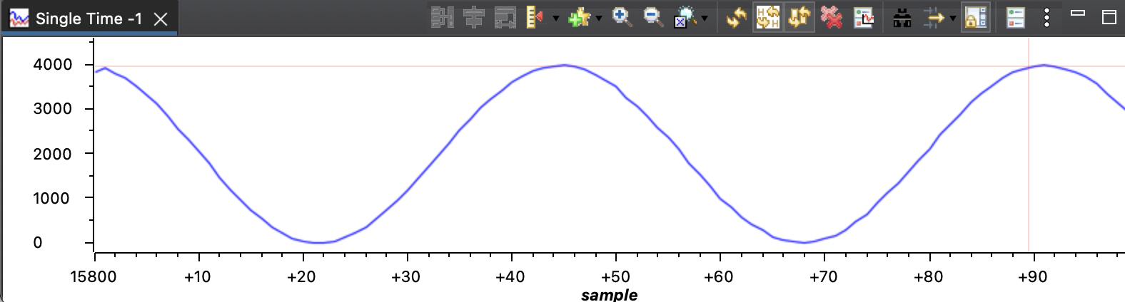

I'm having issues when visualizing data in the Single time Graph. I started with the example adc_soc_epwm_cpu01, to view a sinusoidal signal. If the buffer size is not an integer multiple of the sampling frequency divided by the signal frequency then the signal on the graph gets distorted, this has been reported previously here https://e2e.ti.com/support/microcontrollers/c2000-microcontrollers-group/c2000/f/c2000-microcontrollers-forum/888657/ccs-tms320f28379d-adc-conversion-not-working In the thread someone obtained the correct behavior but using a control card. Additionally, I inspected the memory browser and the data matches the distorted waveform. Is it possible that there are some limitations for real-time debugging in the Launchpad compared to the control card? Or is the issue somewhere else? Thanks for the help.

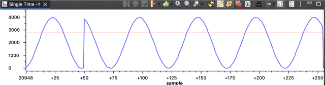

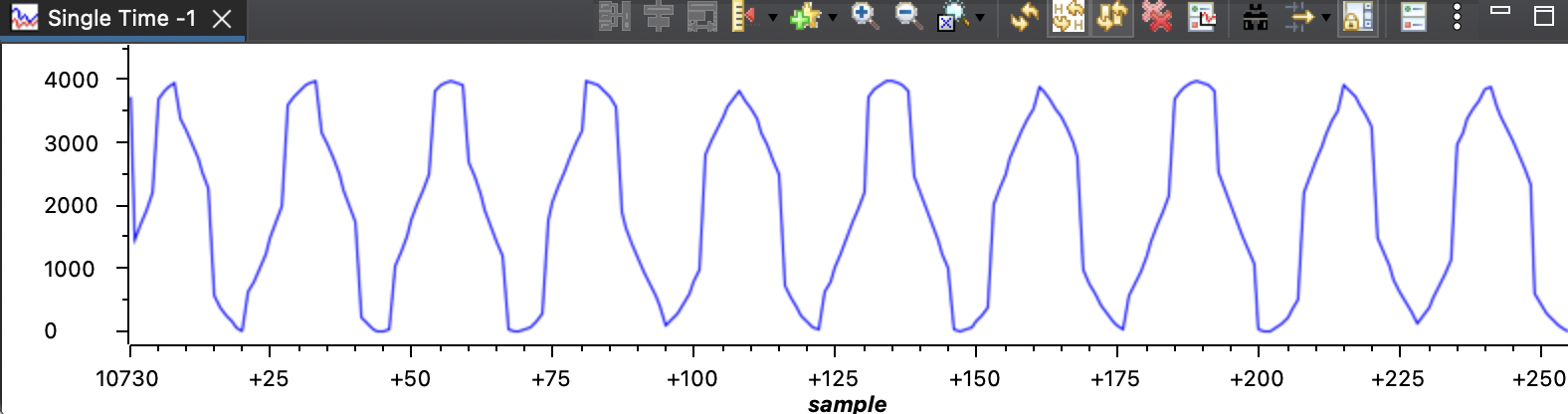

    Thanks for your reply. I am connecting the LaunchPad with the onboard USB and I'm not sure if this allows for full bandwidth or not. Just to be precise, my input signal is a sinusoidal with a frequency of 2 kHz and I'm also using a buffer to collect the data. I modified the code to allow for continuous acquistion, in the original code the process is stopped after filling the buffer one time, and it can be restarted by clicking the Resume button. Here are some pictures of "normal" waveform and distorted ones. For all views of the graph, I'm choosing the Acquisition buffer size and the Display Data Size equal to the RESULTS_BUFFER_SIZE, which is the size of the buffer, and with continuous refresh.
    BUFFER_SIZE  = 100
    BUFFER_SIZE = 110
    BUFFER_SIZE = 256

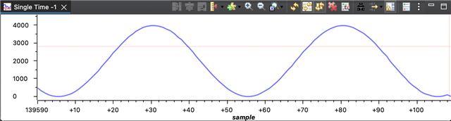

    I experimented a bit more and noticed that the problem only occurs when the results are continuously stored in the buffer. If inside the interrupt I only allow the buffer to be filled one time, the waveform is not distorted regardless of the buffer size, I am adding screenshots of this tests as well.  I can restart the buffer filling by manually setting the index to 0, or any other value that is in the range of the buffer size, in the expressions window. When the graph is updated I get the expected view, for example, with a discontinuity at the index that I set in the expressions window.
    BUFFER_SIZE = 110, index = 0
    BUFFER_SIZE = 256 index = 50
    I hope this gives more insights into where the problem is.
